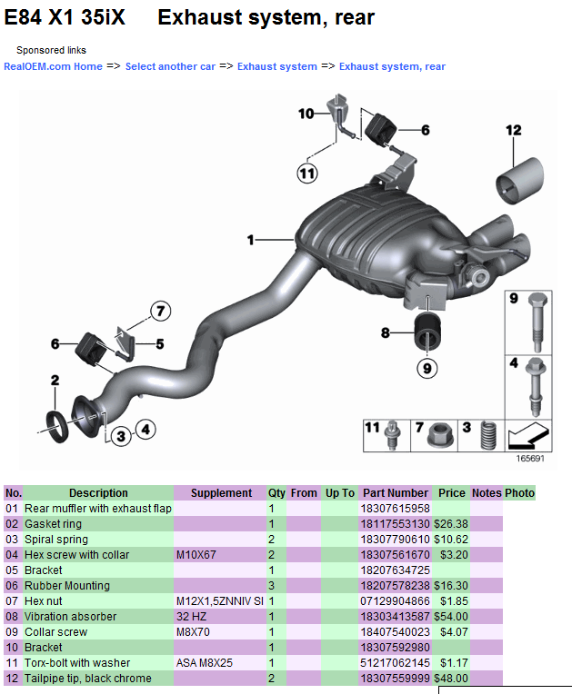

There is a possibility that the 1 series performance exhaust fits. Real OEM shows that they have 99% the same part numbers. No one has been able to confirm this however.
There is no N20 for the 1-series and the N55 exhausts from the 1 and 3 series don't fit the X1 or X3.
99% seems to be a stretch.

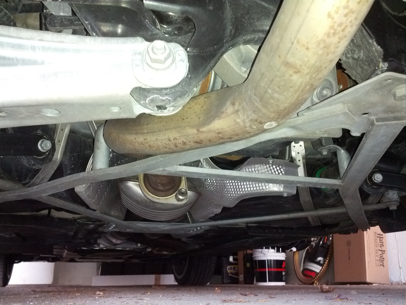

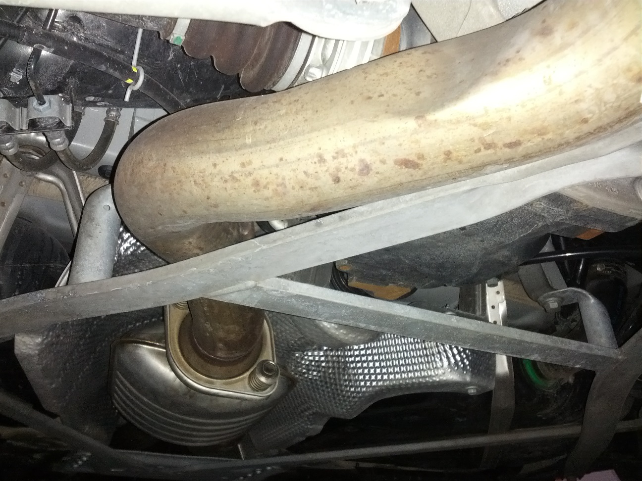

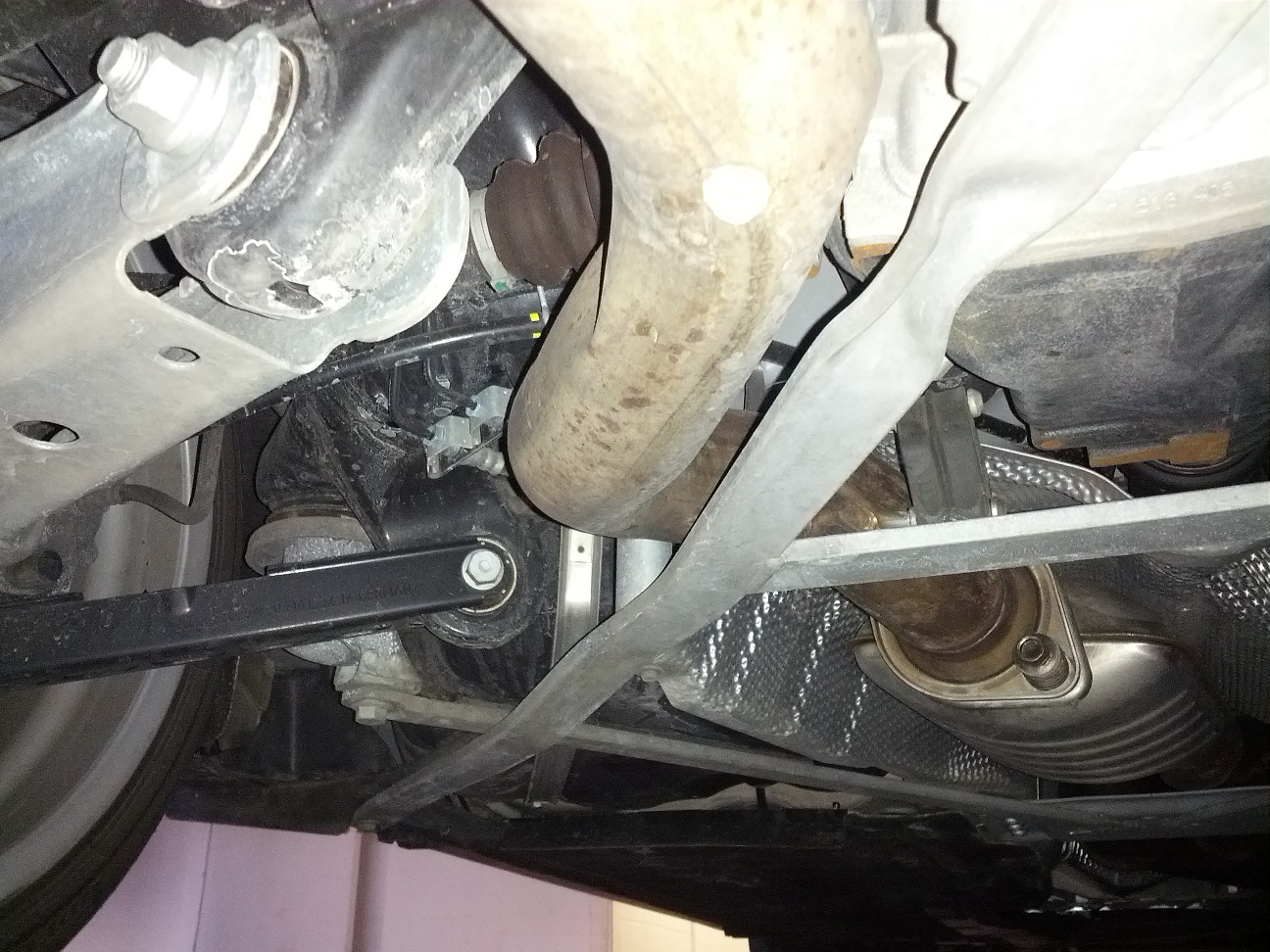

Look what I found online:
http://www.flickr.com/photos/alphoto...93/8273490981/
I'm going to bite the bullet and order for the 35i.
I took a bunch of under-car exhaust pictures and they look identical. The mounting points are 100% the same but the only question is if the pipe will thread through one of the rear chassis braces. Have an email out to a BMW parts guy now and we will see, but I'm 99% sure it will fit - perhaps with the minor modifications.

One more thing to point out - the xdrive 35i's have 2 midpipe catalytic converters. Removing those will take 20min at a shop, cost $30-50), and will increase sound and give you a 10-12whp gain, while NOT triggering a CEL. Plus it is totally reversible - just weld them in for another $30-50 if you ever want to go back to stock.
This is exactly what all the 335 xdrive guys did - the xdrive has the midcats (as do all n54 engines) and a popular mod is removing them (or replacing them with a N55 midpipe without midcats from a 135i, in the case of the n54.)
Also, the other thing I realized is that the BMW PE piping is the same size as the oem piping. Even if the entire BMW PE piping doesn't fit, there's no reason we can't get 100% of the effect of the PE by deleting the resonator, chopping the BMW PE muffler off from the piping, and welding back on to the stock piping.
The bottom line is that this CAN be done for probably $150 worst case installation at a decent shop. Doing the entire mod including secondary cat deletes should be good for around 15whp least based on other xdrive dyno charts (in addition to drivetrain losses, this is one of the reasons xdrive cars always dyno lower stock).

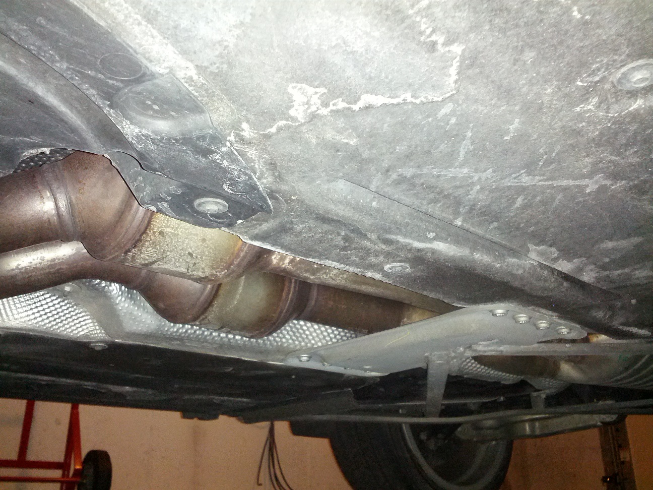

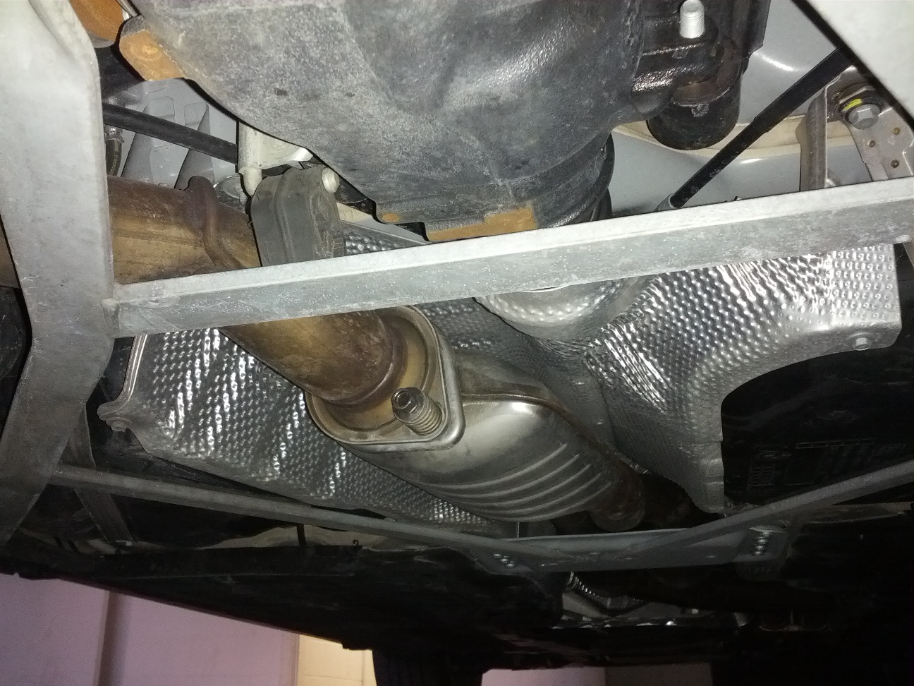

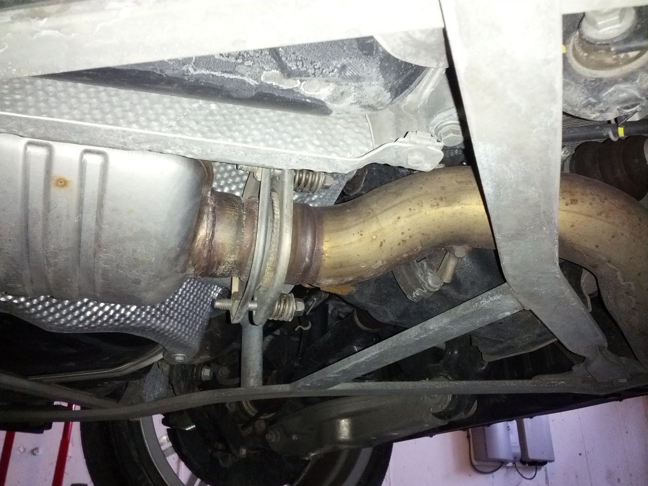

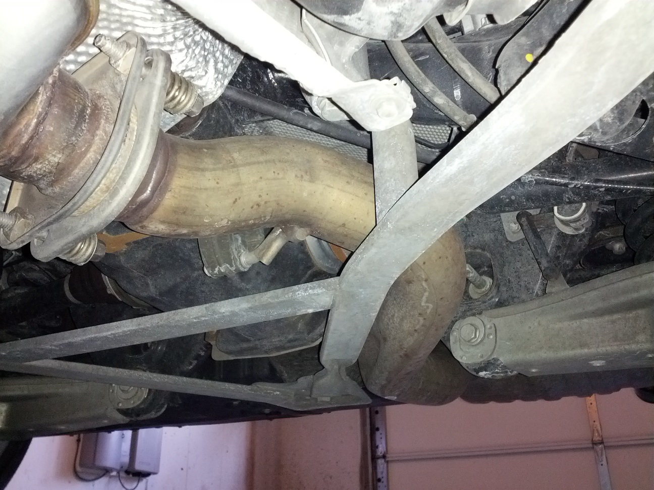

The pics for reference: all of the pics are the stock X1 35i exhaust except the last, which is the 135i exhaust for comparison. You can clearly see the same pipe bends and rubber mounting points.

Thanks for taking the time to take the pics. It really does look similar I must say.
If the local guy with a spare 135i axle back is in town this weekend I may grab it from him for a test fit as I'll have the car on Jack stands anyway while fitting the coilovers.
It would be nice to get hold of a PE, or indeed a number of other aftermarket units to see if they fit up to the X1 with the extra bracing under there.
