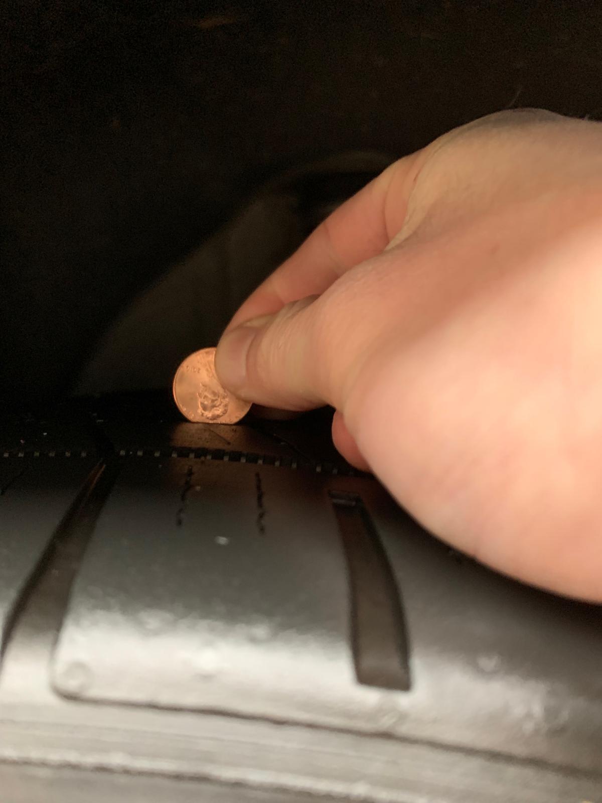

This is my first Xdrive experience. I noted my rear tires are seriously worn, but my fronts look alright. They are factory staggered so I cannot rotate. Traditionally on my RWD BMW’s I’ve owned in the passed with a staggered set I would replace the rear tires twice to ever one tire change in the front. Can I do this with x-drive or is this a bad idea?
Here is a pic of my treadwear. And yes it’s very bald haha.
First pic is rear tire second pic is front tire.
The remaining two pics are the tire wear bars.

Update, tread depth on front tire is 6mm

Always replace at least both tires on the axle... it's OK to split replacement between front and rear... the xdrive system won't notice difference between the front and rear tire treads, but can notice it side by side especially with performance control

Your rear tires are looking to be below safety standards and needs to be replaced anyway.
If your front tires are 6mm it is acceptable to put new rear tires, 2mm thread difference is within xdrive tolerance.

fnp93, not sure how you use the car and what tires are on it but 6mm on the tread means the front tires should be ok for a while. Once you get to 3mm of tread remaining, performance (especially in wet conditions) is noticeably degraded, but you should have at least a year before getting to that point.
Obviously if you can afford, it is usually cheaper to replace all four tires. Up to you in the end
