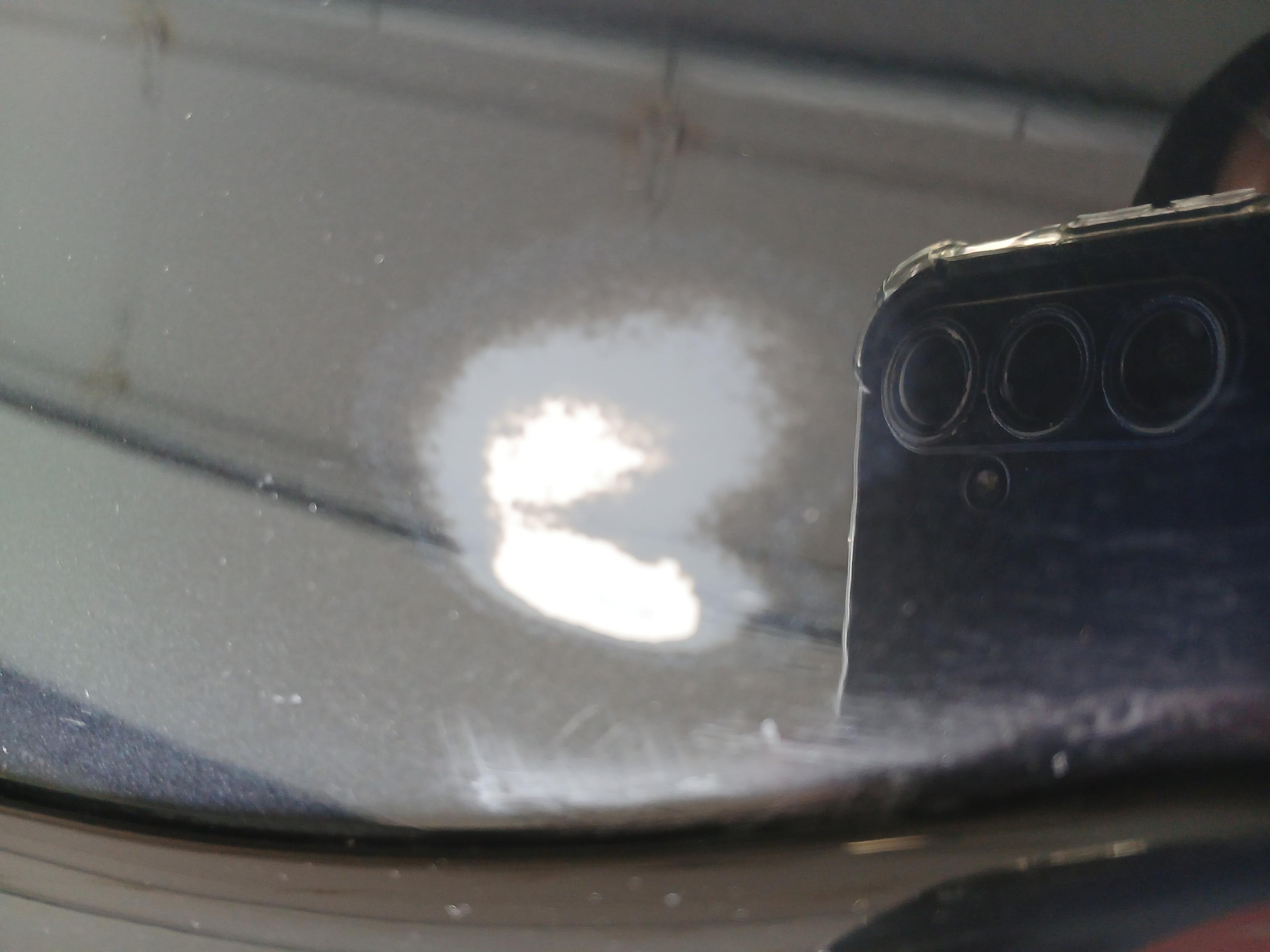

I tried fixing a scratch on my car and sanded way too far. Looks like I went through all the clear coats, paint and primer??
I have the matching paint via Dr colorchip. Tried applying it and polished but still have the same problem.
Suggestions??
Sorry, but lousy camera focus makes it difficult to say what's what.
Either way, you have little choice but to apply the touch-up paint, then try to blend it into the rest of the paint surface through careful sanding.

Yep, you have certainly gone too far.
It's time for spray paint. You'll have to try and feather the edges, or take it to the end of the panel. Unlikely to look perfect. Might be time for an estimate at a shop.

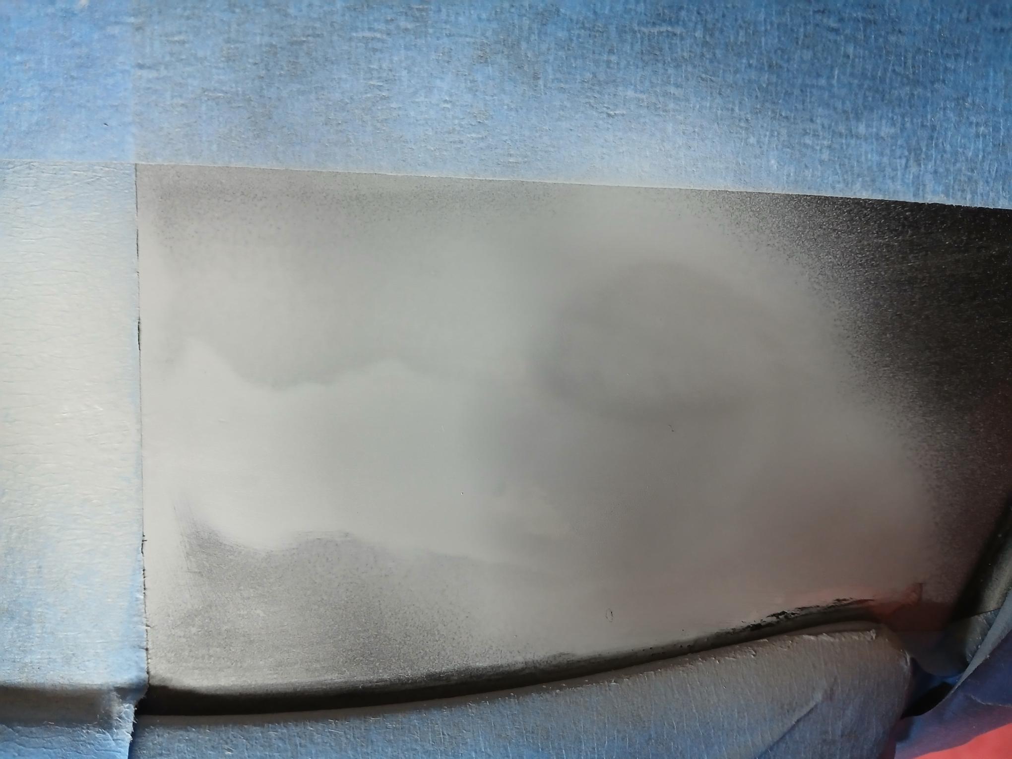

Any suggestions on the different grits of sandpaper? I do have 3000 grit and aggressive 120, 220 which is how I originally screwed it up...

Oh, damn. Any pictures of the original scratch? It feels like you were far too heavy-handed with this but I also don't know what the scratch was like. Beyond the obvious issue, it looks like there are sanding scratches outside the crater as well.
You 'could' fill this in w/ Dr Colorchip (even though it is not intended for large area repair) but you are beyond simple rock chip repair kits at this point and into 'multi-stage repair' territory.
You could DIY it but....you are probably better off going to a body shop (no offense).
On the plus side, you got rid of the scratch.
The trick is to wrap paper over horizontal block that overlaps the repair area. Then hold the block as horizontal to paint plane as possible.
This way you sand only over the touched-up paint spot, and not the healthy paint areas. Start with wet-sanding, and Go Slow!
Anything more coarse then 400 (really more than 800) is way too crude for car paint.
Start with 1500, and see if that does the trick. If not, go one level more coarse, or just go slow!
HTH,
a
'15 F80 M3 (SO/SS)
'21 TM3P (Blue/White)
'25 Lexus RZ (White/Blue)
HTH,
a
Thanks afadeev! I'll start over with your suggestions and see what happens. Keep ya posted.

Like afedeev said use 1500. Hell I hate trying to get rid of 1500 because it takes 2000, 2500, 3000 and some compound/polish after. But you have to do what you gotta do.
Definitely use a firm foam sanding backing pad and don't press hard. Make sure you get the colorchip paint above the existing paint level before sanding>

You're probably right however my next attempt was to apply primer after once i buffed it smooth. I will try paint tomorrow after dries thorougly and see where this gets me.

You will most likely won't be able fixed this yourself. Especially after sanded down all the way to primer layer.
Definitely recommend bring it to the shop! They will most likely have to respray the whole bumper. I dont know the cost but won't be cheap but not crazy expensive.
