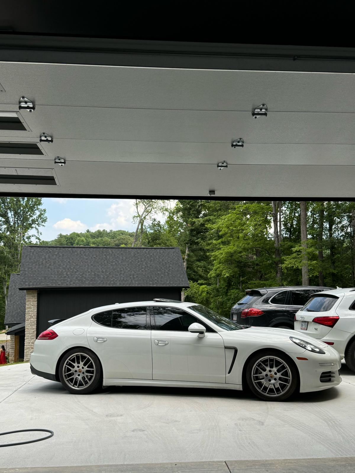

Hey guys,
Needing some advice here, so I ended up buying a Panamera for a really good deal, the downside was that it was a smoker’s car. When I removed the cabin filter it was black!! Immediately like 40% of the smell was gone with the new filter and a few days of driving. I then got the interior detailed, but I did not like the job done by local auto spa. I also did the ozone machine method and right now I’d say 25% of smell is still there and on top of that the ozone smell is also there now. Cigarette smell is very specific and even with 25% you can still pick up on it especially when just getting in.
What to do next? I will air it out and ozone smell should desipate, are there leather cleaning products that have some kind of enzyme that will eat the smoke particles in leather? Should I wipe it all down with vinegar? Maybe new car leather conditioner?
Please post your suggestions please!

I have to say that it’s getting better and better. Especially the fact that it’s sitting in the sun, it’s not that bad anymore. My wife who is pregnant can smell it from a mile away though.. lol.
