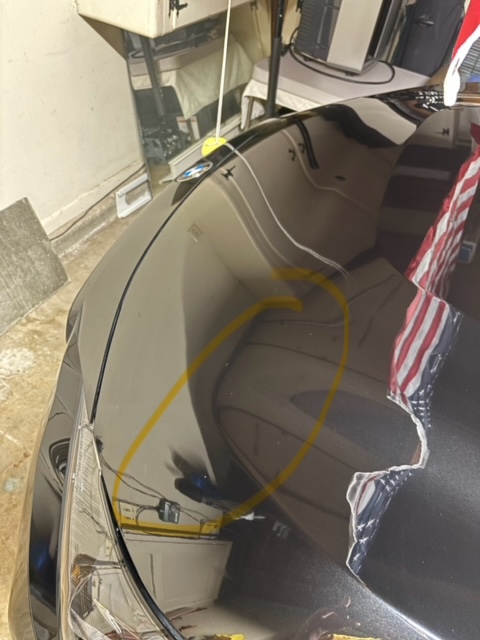

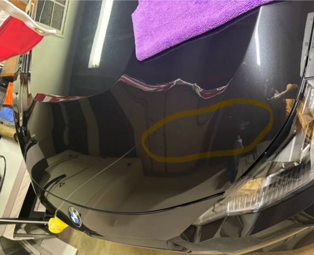

Purchased a used 2022 black m240i w/ 14,000 miles on it 2 months ago. Previous owner had taken pretty good care of it and only had a couple blemishes (a few small paint chips).

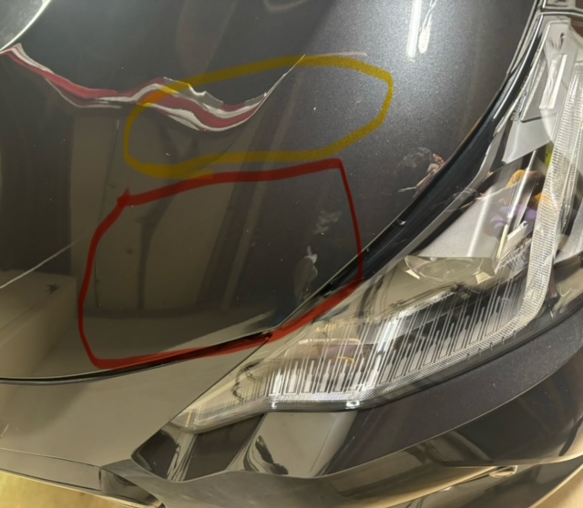

I was inspecting my car a couple days ago and noticed a bunch of small (even smaller) paint chips on the hood, specifically the front driver side. The chips are not as large as the few the car came with but if you look closely, you can see it. I am assuming this is from a car throwing up sand and small rocks in front of me? However it happened, it happened.
The pictures below shows the chipping. Yellow circle indicates the chips that were already there. Red circle indicates the new smaller chips I recently noticed. **After posting this thread, I realize the "very small" chips are hard to see in the red circle. They are very small and rang from pin need to sand of grain. When the car is the garage at night, it is easiest to spot.
Does anyone have some insight on how to go about fixing this?
-Claying and polishing to fix/fill these smaller chips?
-Purchasing correction paint and putting small dots on the hood?
-Taking it somewhere? If so, what procedure to have done?
Lastly, the car came with PermaPlate Paint Guard and I had the coverage transferred to me. has anyone successfully filed a claim with them? Appreciate any insight!

I recently bought Dr. Color Chip because in the past I've been dissatisfied with OEM touch up paint. In fact, there were a couple rock chips on my Z4 from previous owner the dealer put on BMW and it looked terrible.
The Dr. Color Chip stuff works great and is perfect color match. I definitely recommend going that way, especially if you're not comfortable doing anything crazy that might make it worse (which I'm not).

I used Dr. Color Chip on my old E46 in Titanium Silver and was happy with it. I'd look at YouTube for videos and get some pointers before attempting the project.

I've used both Dr. ColorChip and Chipex. Both are good products and the color match is far superior to any OEM touchup paint. They are both extremely easy to use as well.

I will be purchasing touch up paint from Dr. Color Chip. Thanks to you and the other commentors! Looking forward to getting this done.
