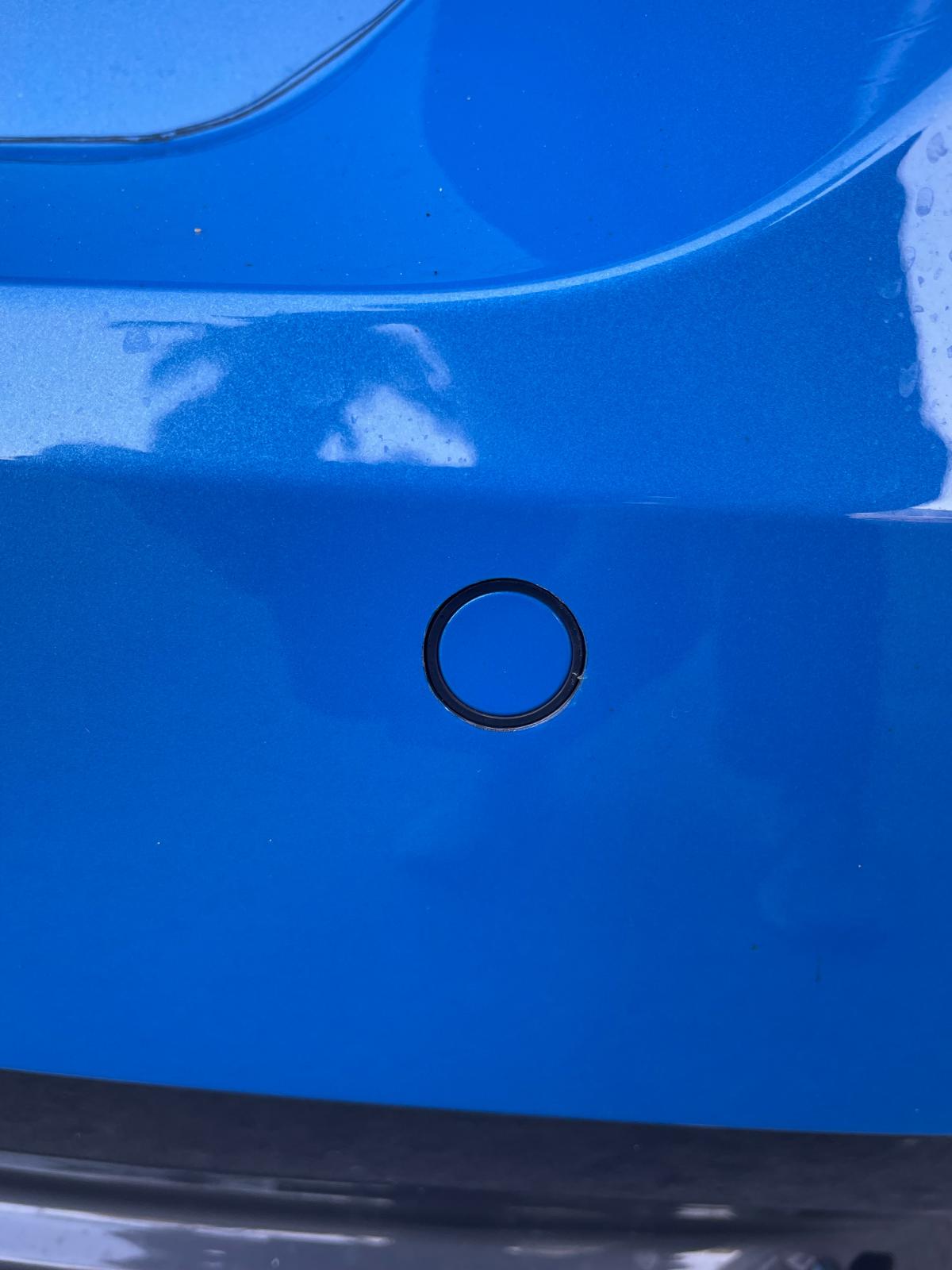

Interesting...my sensors are fully covered with ppf and I've had no issues:

My sensors are sealed with my bumper so it's one big piece no cut outs. It hasn't affected the sensors at all. My rear bumper is also sealed and no issues either.

My sensors are not totally covered. My shop used a very fine blade and cut into the PPF.

The sun finally came out and dried everything out including the moisture behind the PPF over the sensors and and I am no longer getting any warnings - its working just fine now.

I've seen it with PPF & wraps. It should clear up - if not, let the installer know.
