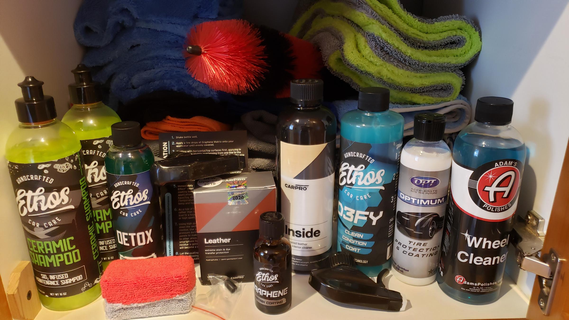

Haven't seen a posting on Graphene. This is the new generation to Ceramic that is supposed to be superior in two main ways by having a longer life (5-7 yrs) and better resistance to water spotting. I am not an expert detailer, just a DIY'r. I had done two higher mileage cars with Car Pro Cquartz. Along with paint correction, this was a great product and well worth the effort. My S60 done nearly 2 years ago looked great when i just sold it. I really liked the spray on topper (Reload) after every couple maintenance washes.
I am taking delivery of a new X5 Late September and am geared up to do a light polish and apply Ethos Graphene. One concerns i have with Graphene is the fact that they don't really have a specific maintenance topper. Ethos has a product called Defy that i hope will help with that, but it doesn't sound like it is as paired as the ceramic base and Sio2 toppers were.
Anyone use a graphene yet?

I maybe more prepared for my X5 baby than i was for my 1st child. Read to roll

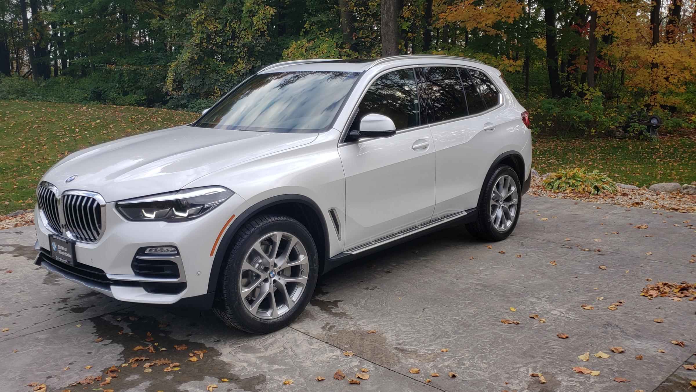

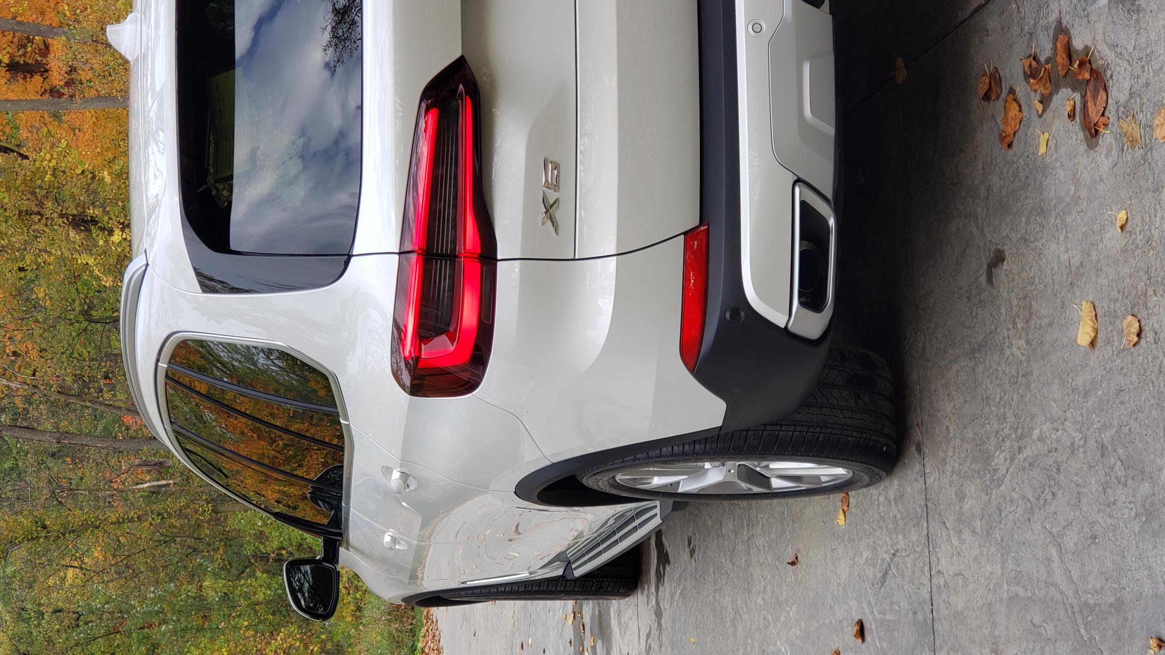

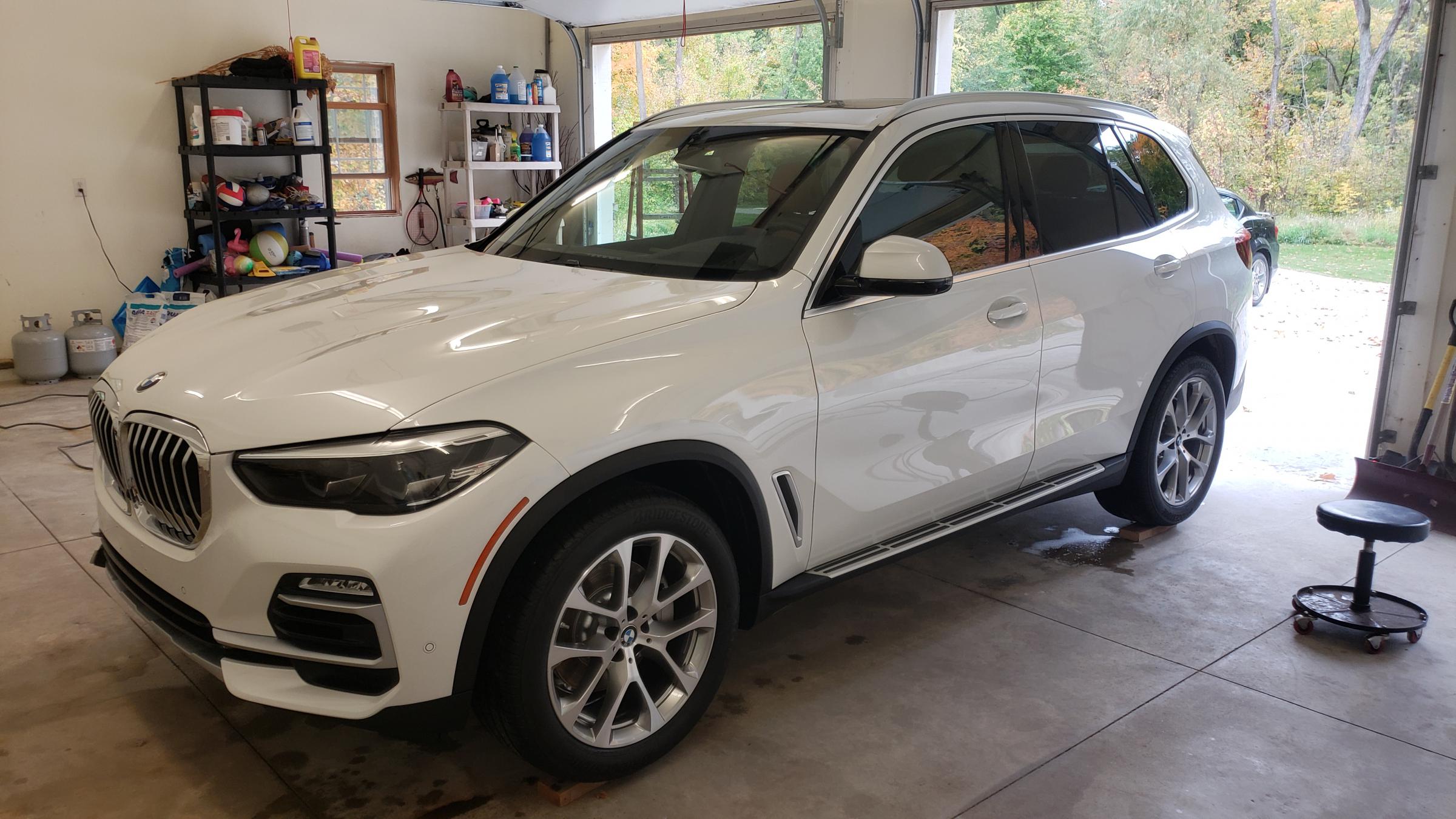

last Friday I completed the first wash, light paint polish and graphene coating. The graphene went on very well. No major differences between ceramic and this graphene. A little slower flash time. Looks great, while polishing, the gloss after polish was pretty noticeable between panels that I had just polished and a factory panel. Definitely worth the effort. In Mineral white its not as easy in photo as a dark mirror finish but looks great. I did not have enough product to get the wheels coated so I will need to do a wheels off coating after getting another small bottle. Tires have Optimum Tire (2 coats)
