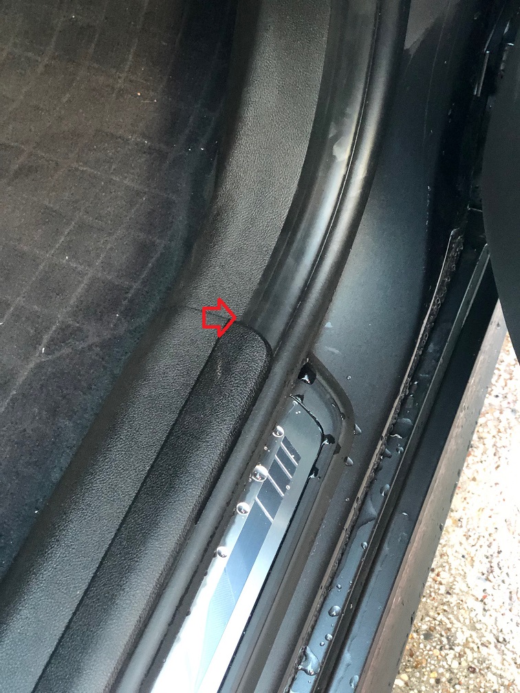

Today I accidentally discovered that after washing the car using pressure-washer there is a wet spot on the floor under the carpet, on the passenger side. It was small but really soaking wet. I marked the spot on the attached picture. Everything else was dry, no trace of water whatsoever. The water must have come from under the plastic trim. I was really careful with the lance, keeping the distance etc. I will report it to the dealer of course. Anyone with a similar issue?

Ok, I did some tests before I book the visit at the dealership.
Water is appearing inside the cabin only when spraying around passenger door edges (low pressure, from the distance). The water starts flowing with smal stream after approx 5 sec. It is coming from under the rubber seal exactly at the spot marked by the arrow.
Honestly I don't know how much I should be worried - I assume water is somewhere under the trim, where it is not supposed to be. Let's see what the dealer says.
Or maybe there are some critical spots that I can check by myself? To my untrained eye all the rubber seals are perfectly fine. Any advice where to look and what to check?

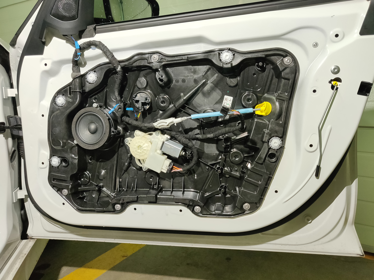

In my case it was factory damaged seal on this big plastic piece inside the door (the one that has the speaker and everything else attached to it). The bottom seal was broken and the water that was getting inside the door was not being directed into drainage point and instead was leaking from under the door.

They've replaced the whole big plastic piece that is inside the door. The seal on the bottom edge that was broken is it's integral part. See my attachment (pic is not mine, found on this forum)
And for the floor carpet they simply allowed it to dry completely, but the leak was not that severe, it wasn't completely soaked, just a spot next to the door.

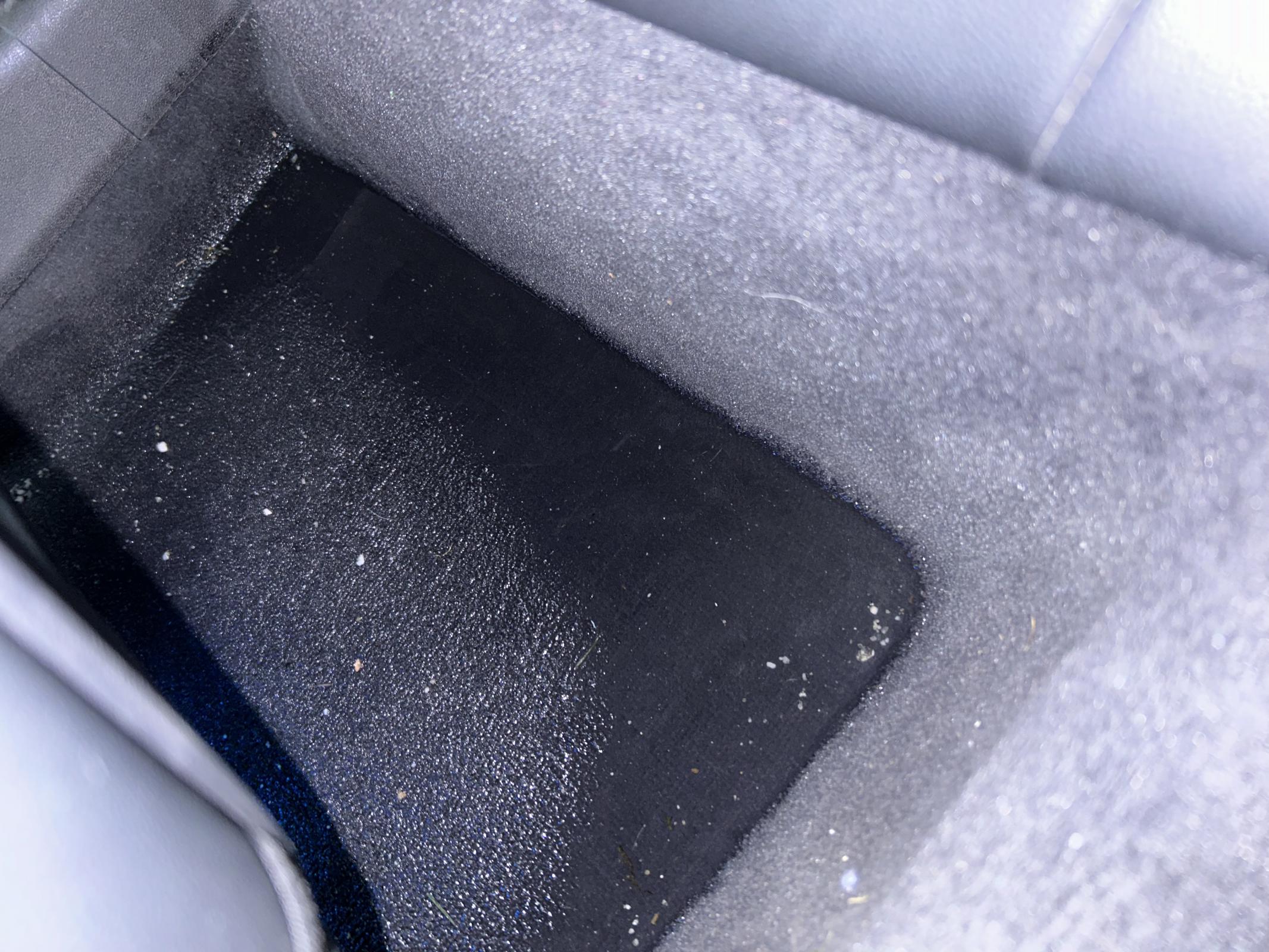

The same thing happened to my son's car shortly after he bought it used from Arizona. The back seat foot wells would be full of water. He had a warranty, so we took it to the dealer, and they resealed the film behind the door cards on the rear doors. The problem has not reoccurred. I can't recall the name of the sealant. Its thick and sticky stuff.
Butyl..I think

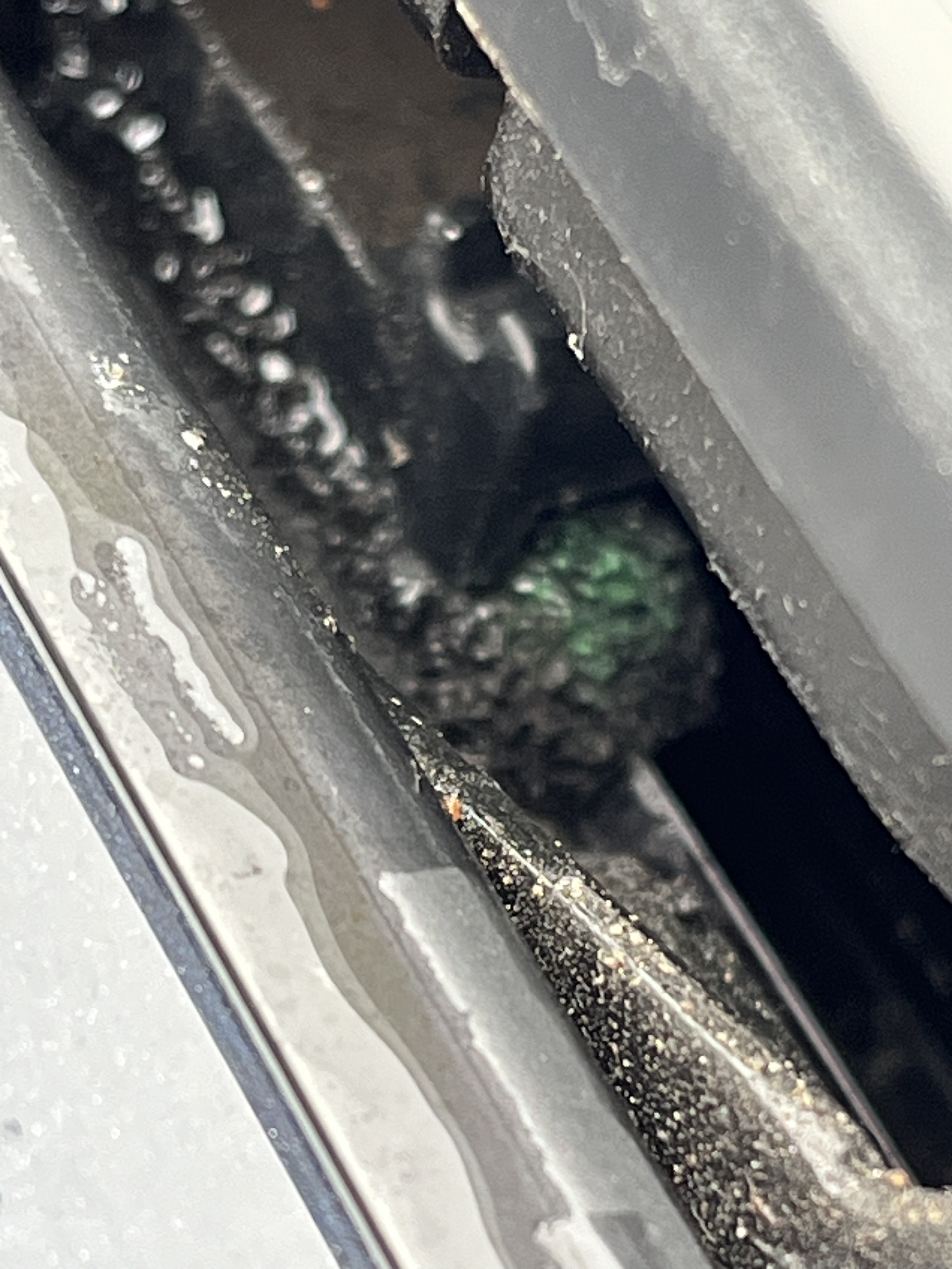

so the leaking sunroof saga continues .. it seems that the inner channel on the sunroof runs directly into where the mic is, so after investigation I'm replacing the seal.
My question is though, there are 2 little 'spongey bits at the end of the seal, pictured here. Has anyone any idea of the part number for those little guys?
New drip seal BMW - 54107493149
