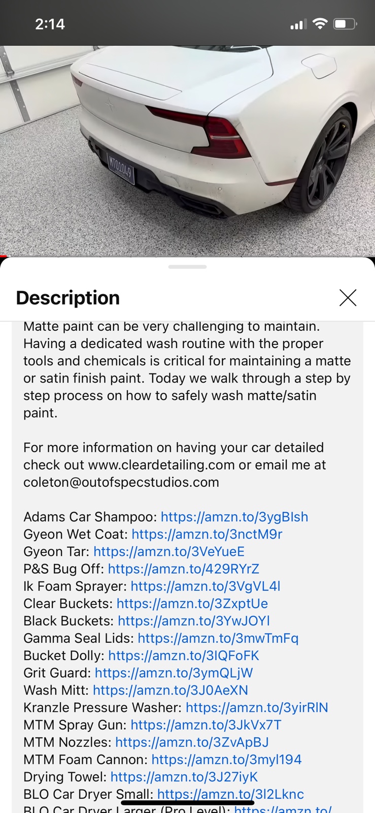

Not that my matte paint would ever get this filthy, but I watched a pretty decent primer on washing matte paint, and I question some of the products recommended bc I cannot find if they are matte paint safe, despite his testimonial and him obviously using them
Specifically:
-Adam’s Car Shampoo
-Gyeon Wet Coat
-Gyeon Tar Remover
-P&S Bug Off
Anyone use the above referenced products on their matte paint?

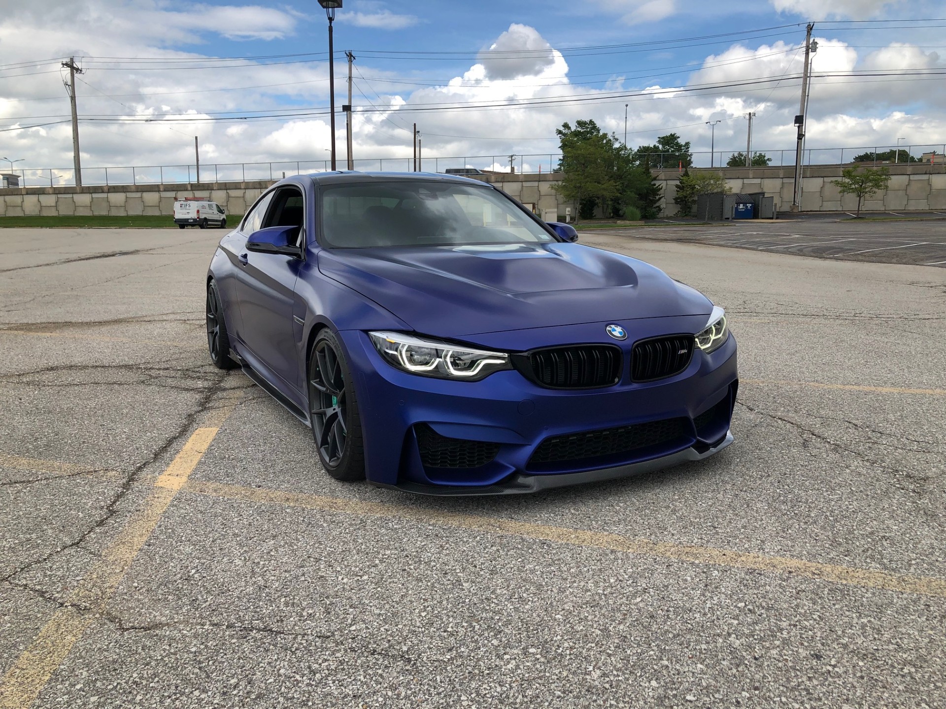

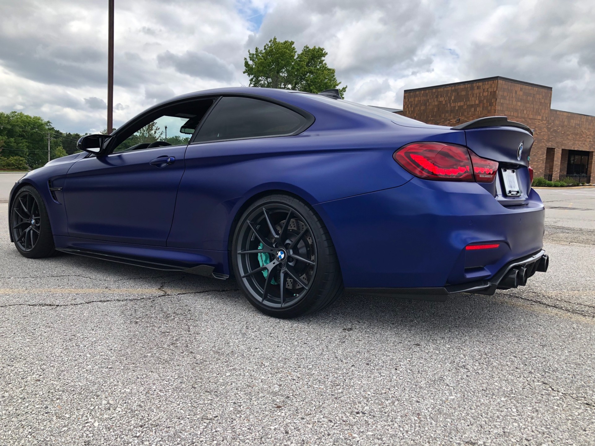

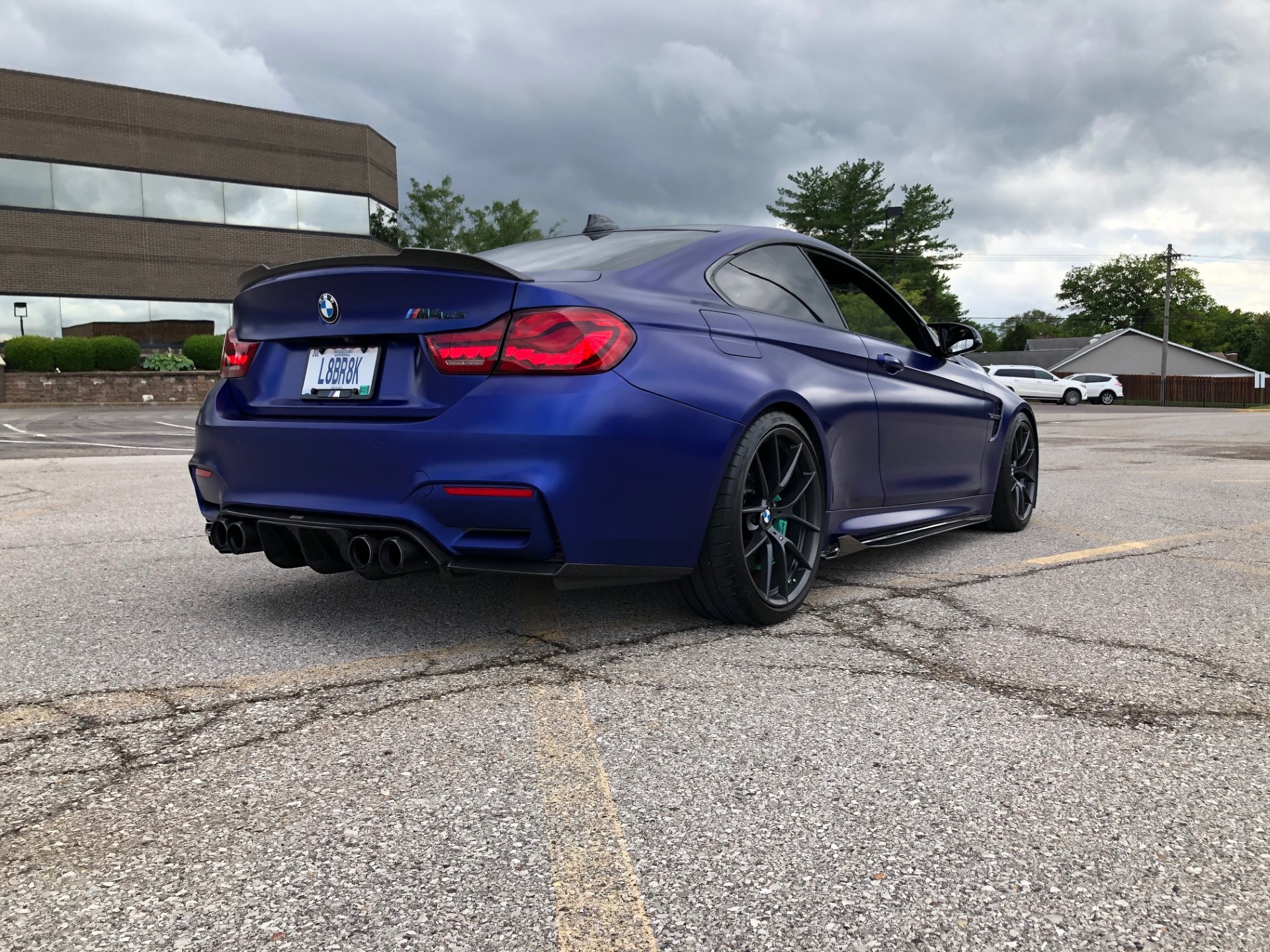

Hit my car with its second round of BMW matte wax. Took around 4 hours, but I think it came out great. I highly recommend this wax, it had been about a year since the prior coat and the product inside the bottle was still perfectly fresh. I do so love this car.

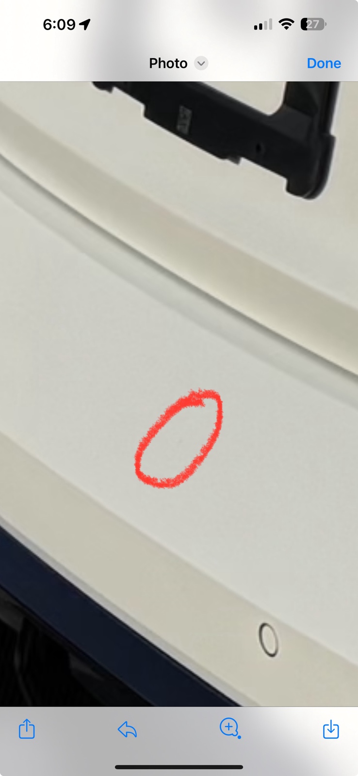

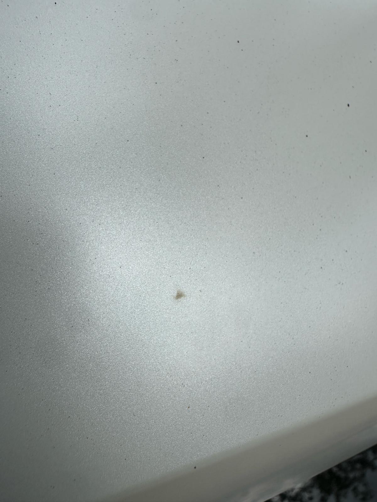

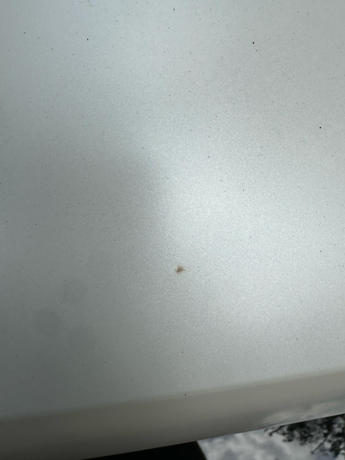

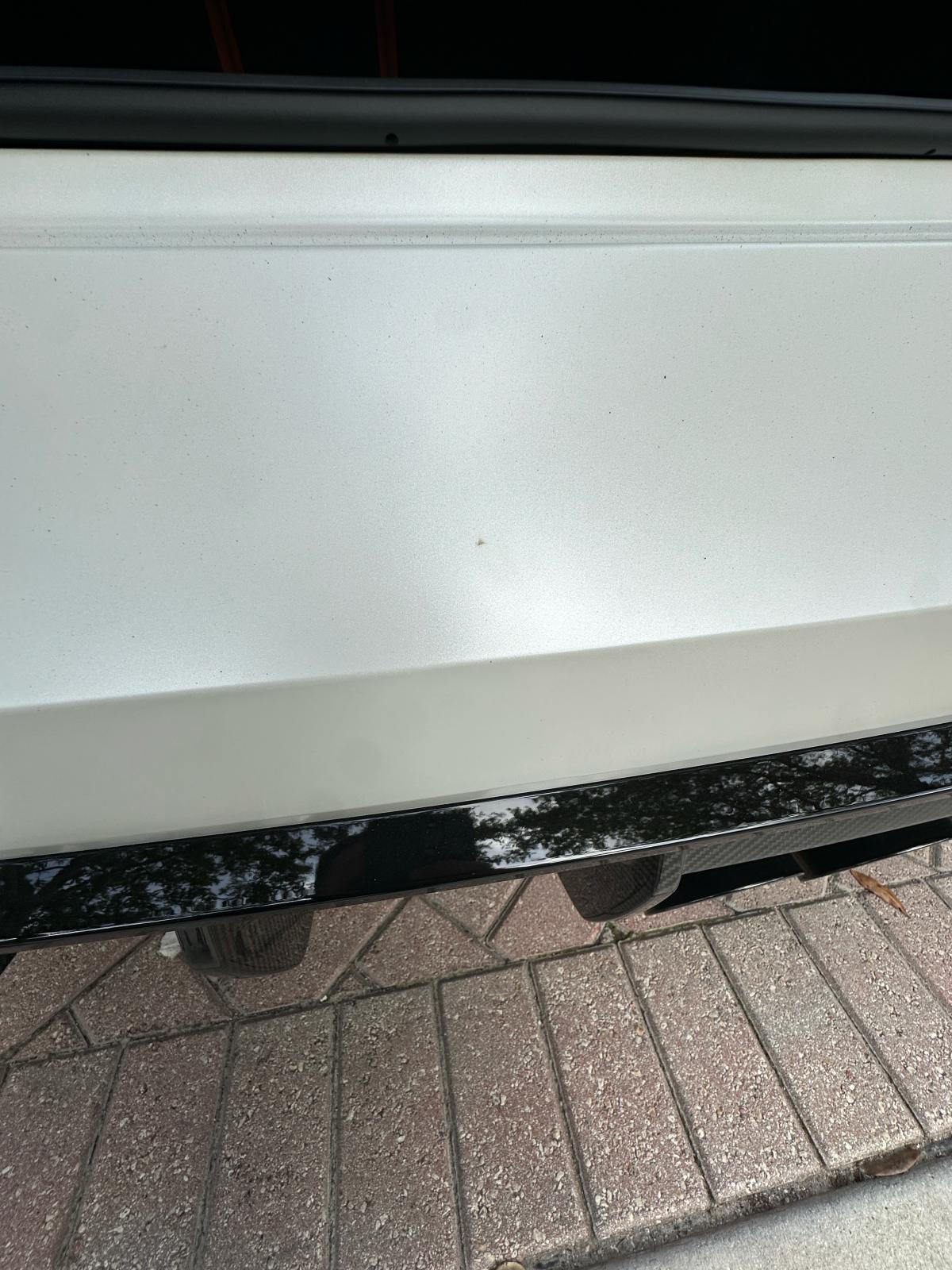

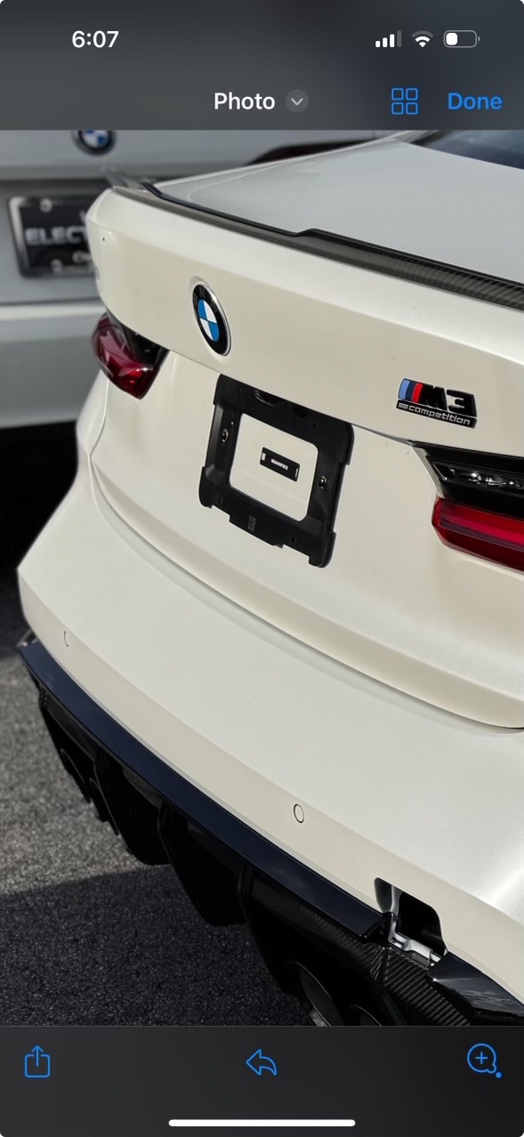

I just picked up a new frozen white G80, which already has a stain on the rear bumper. The car was ceramic coated yesterday, and the detailer was not able to remove the stain. Can you tell me how this stain can be removed? It looks like it came with the car when it was purchased at the dealer. I’m having conversation with the sales person about it as I’ve read these stains get baked in and there is no removing them

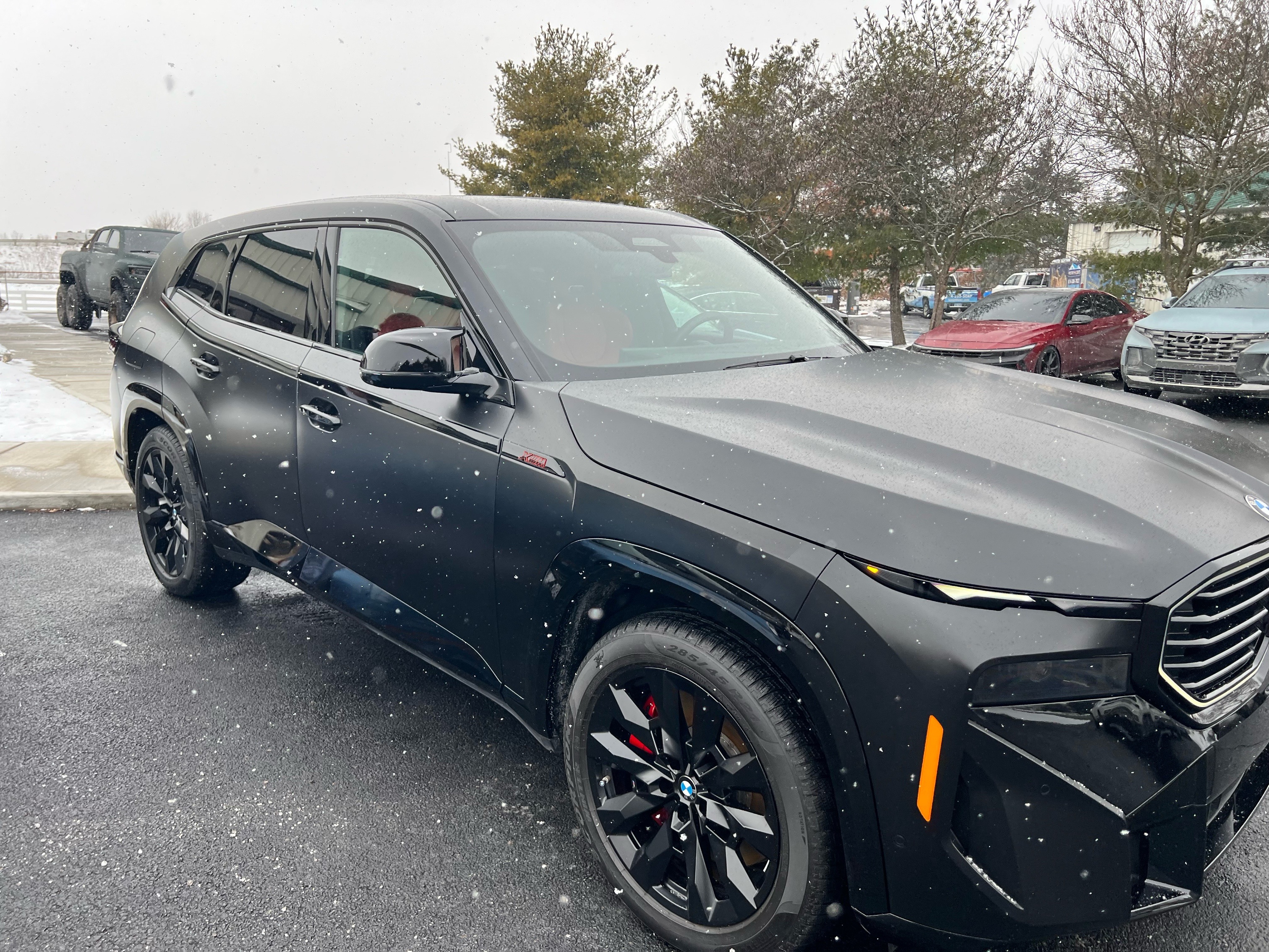

Really a great story about frozen paint I find the paint very safe I plan on driving my xm label frozen black and enjoying the car that’s me . I have 4000 miles in almost 6 months it’s fun . Well said the paint makes you think maybe even stress … can not imagine driving thru fires hearing things hit your paint and you wonder if it’s ok that’s being human . I ask myself did I buy the right paint there was a gloss black and frozen black both labels when I picked my car out … novice me I loved the look of the frozen hands down for less stress the gloss would have been the easy choice no question sometimes wish I did pick the gloss BUT I do love the frozen black look along with all the lines on the car that was designed to give you a constant array of colors in changing light that only frozen paint can . I quickly had to step up my game a lot on my car care that I wasn’t ready for but I found a new love of taking care of my car in a proper way and it’s been fun .
I wash indoors it’s fun I threw away all the gimmick stuff even the bmw products funny they say only soap and water but let us sell you this and this everyone has a special black Matt product and saw me coming . I have a cabinet of special Matt products I will never put on car ever .
The only bmw product is the leather protector I like that . The rest no thank you .
Jimbo’s detailing super soaper soap yes perfect , his hard as shell ceramic spray yes … I tried inside the doors first worked my out love the product my favorite. And V and water water stains what have you wife’s idea and saw it other places it’s golden … the Jimbos is water based products I love that have a system now and can sleep easier .
As much as learning was challenge so was avoiding all the gimmicks to buy for Matt black care . Like x5 MN said in his post the frozen paint is a tough strong paint more then you think … my xm label was very dirty on one trip of 2 trips I took it on ok got a call from wife was talking to her lost my thought not paying attention and took my car in a car wash yes brushes I am in the wash on the phone and I realized what I just did and was absolutely horrified of what I was doing out of habit . I came out of the wash wanting to absolutely die and turn my car back in for just being so stupid . The dumbest BMW owner who ever lived right there ..And to my unworthy amazement not a mark not on the paint only a small swirl passenger lower piano trim that came out with a ceramic spray to never appear again . Was shockingly stupid and so lucky at the same time but learned some very tough paint . Telling the story hurts.
I am going to hold off on PPF for the rest of my car besides the front because I love the frozen look … I know there is a rock and drunk bicyclist just waiting to scratch my frozen paint as I type ok but when that happens I ll deal with it and if they get so bad then I ll repaint the frozen . But usually I don’t get Rock marks in my side panels or door dings I try all I can to avoid but life happens I get it . We will see but if it happens like in life I ll deal with it . Would rather take that PPF money and have BMW repaint it before I cover it all up .
It’s a very tough paint like X5 mn said .
Specifically:
-Adam’s Car Shampoo
-Gyeon Wet Coat
-Gyeon Tar Remover
-P&S Bug Off
I'm also curious about this. I have quite a bit of adams car shampoo so that would be great if it does work good. Here's a quote from Adam's website for this soap: "Adam’s Car Shampoo can be used in full sun and is safe on all surfaces including glass, headlights, plastic, paint, raw aluminum, and matte finishes.
