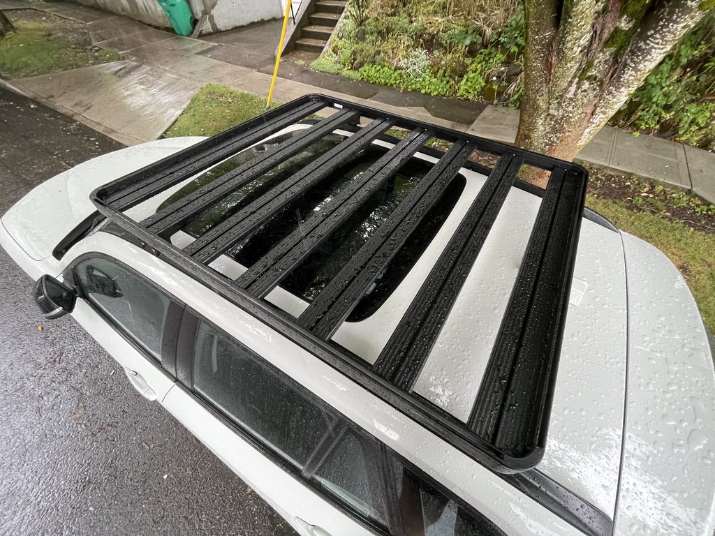

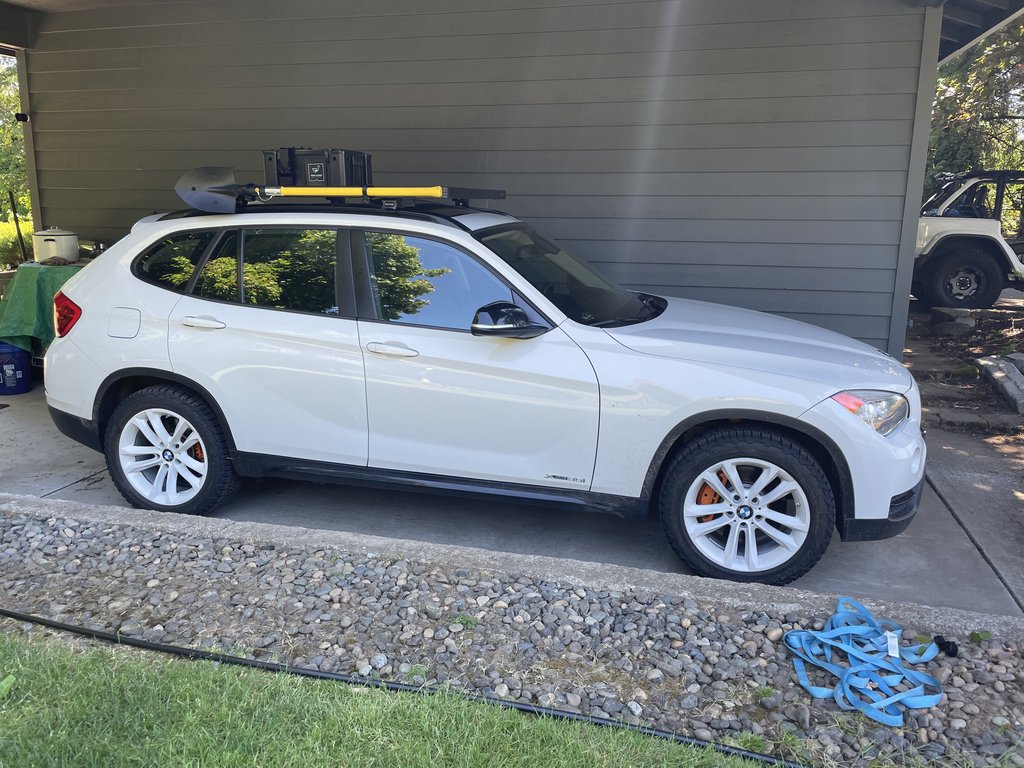

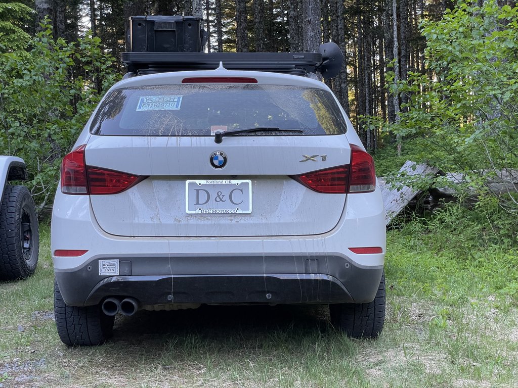

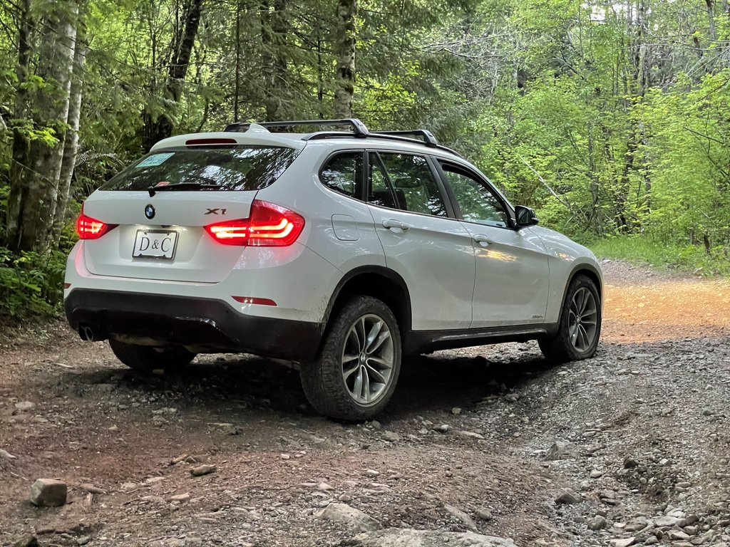

      06-23-2021, 03:51 AM   #73
Kandrew
Driver
Kandrew's Avatar
Drives: 2018 BMW M2
Join Date: Apr 2018
Location: Portland, OR
I’ve been following this thread for a long time, and finally this year I began my X1 build. I also have more serious off-road / 4x4 friends who doubted the capabilities of my BMW. I’ve taken this up some fairly serious trails, and it has exceeded all expectations.
I will be shooting video of this one on some more demanding trails soon

      06-24-2021, 08:56 PM   #74
Kandrew
Driver
Kandrew's Avatar
Drives: 2018 BMW M2
Join Date: Apr 2018
Originally Posted by atrig View Post
The suspension mods are eibach pro lift springs and 20mm strut spacers. The bmw mudflaps had to be shaved down in some spots to prevent tire rub. Super happy with how it all came out, love my X1!
How is the alignment with the lift springs and strut spacers? What offset wheel are you running, and any issues with rubbing for you? I have the eibach springs too and have been wondering if the strut spacers would work at the same time

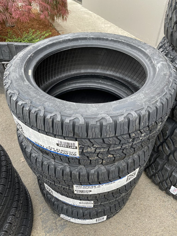

Kandrew, is yours lifted? Looks like stock wheels, but what tires are those?
      09-27-2021, 02:11 AM   #77
Kandrew
Driver
Kandrew's Avatar
Drives: 2018 BMW M2
Join Date: Apr 2018
I have the Eibach lift springs and Bilstein B6 struts but it is not much taller than stock. The tires are 235/50r18 Falken Wildpeak AT Trail. They do rub a little, but it’s not bad.
