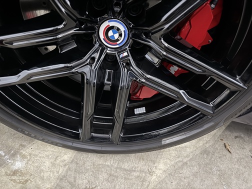

Great tips from everyone here.
For those who cannot wash their vehicles where they reside , like my situation.
This is what i have come up with. I love washing my cars. It’s just a different feel to walk up to a nice clean car.
I utilize a 24 hour self car wash place since we’re not allowed to wash cars where I reside ( ecological preserve , hence no chemicals can be dumped into the ground)
1. Iron and fallout remover sprayed onto the wheels ( regular spray cannon from home depot)
2. While that sits and does its thing I prep the buckets ( 3 in total)
3. The wheel and tire bucket gets the Gtechniq ceramic g wash to add some slickness and hydrophobic properties to the wheels.
4. Spray on the gyeon tire cleaner and agitate.
Clean the spokes etc using a flat Wooly and detail brush.
Once completed, pressure wash the wheels along with the car top to bottom.
5. I have the Ik e foam pro 12. 1:40 dilution. Gtecniq citrus foam.
First spray and let it sit. Pressure wash to remove the media.
6. Second foam spray ( one fill will last two full sprays)
7. Once that sits for a bit, wash buckets used ( 2)
The usual 2 bucket method. ( gtechniq ceramic G wash as the washing aid)
8. Once done with that spray it down and use the facilities blower ( it’s actually nice)
9. Clean the wheels ( becaue brake dust lol) ( dry and dressing etc) chemical guys tire shine
10 dry off the car gyeon micro fiber towel
11. Every 4 washes or so I do a Gtechniq ceramic sealant just to protect it better.
Clean the glass and done.
I have to do this late at night since the place prohibits bucket washing when people are waiting.
car has full front + rocker panels + luggage strip PPF
Full exterior ceramic coat.
hope this helps. I generally take around 2 hours to wash it. but I also take my time with things. I could probably get it done quicker but I’m generally not in a hurry when I wash my cars

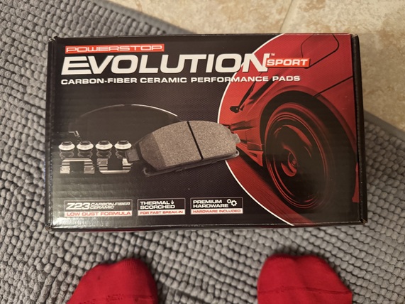

****Pic of what I installed is below. I replaced both front and rear pads. It came with all new hardware which was very nice. I bought extra caliper pin and spring lube, cleaned everything very meticulously before installing the new pads and hardware with a bit of lube on all pins and contact points with the calipers from the springs, etc.. The pads on both ends seem to retract very well and not add extra friction, nor vibrate to cause the screeching sound I have heard on other cars with stock pads after some time. Seems like a great design.
The feel is virtually identical to the stock pads - I honestly can't tell the difference and the car stops quietly now versus the sometimes ridiculous screeching I would get from the stock pads on a pretty low mileage car (7k miles) and with an almost ridiculous amount of brake dust on the wheels and tires within perhaps 10 miles or less of city driving, which drove me nuts.
Now, the dust is reduced conservatively 90%, car stops *quietly* now, and seems to me to stop at least as well as the stock pads. I'm super happy with the pads and how clean my wheels stay now. Even the wheel weights have stayed clean whereas before they were covered in dirty brake dust very very quickly. I like driving clean cars and the stock brake pads I guess are organic pads as they were on my Benz which I also swapped out for low dust pads.
Very pleased with it all.
