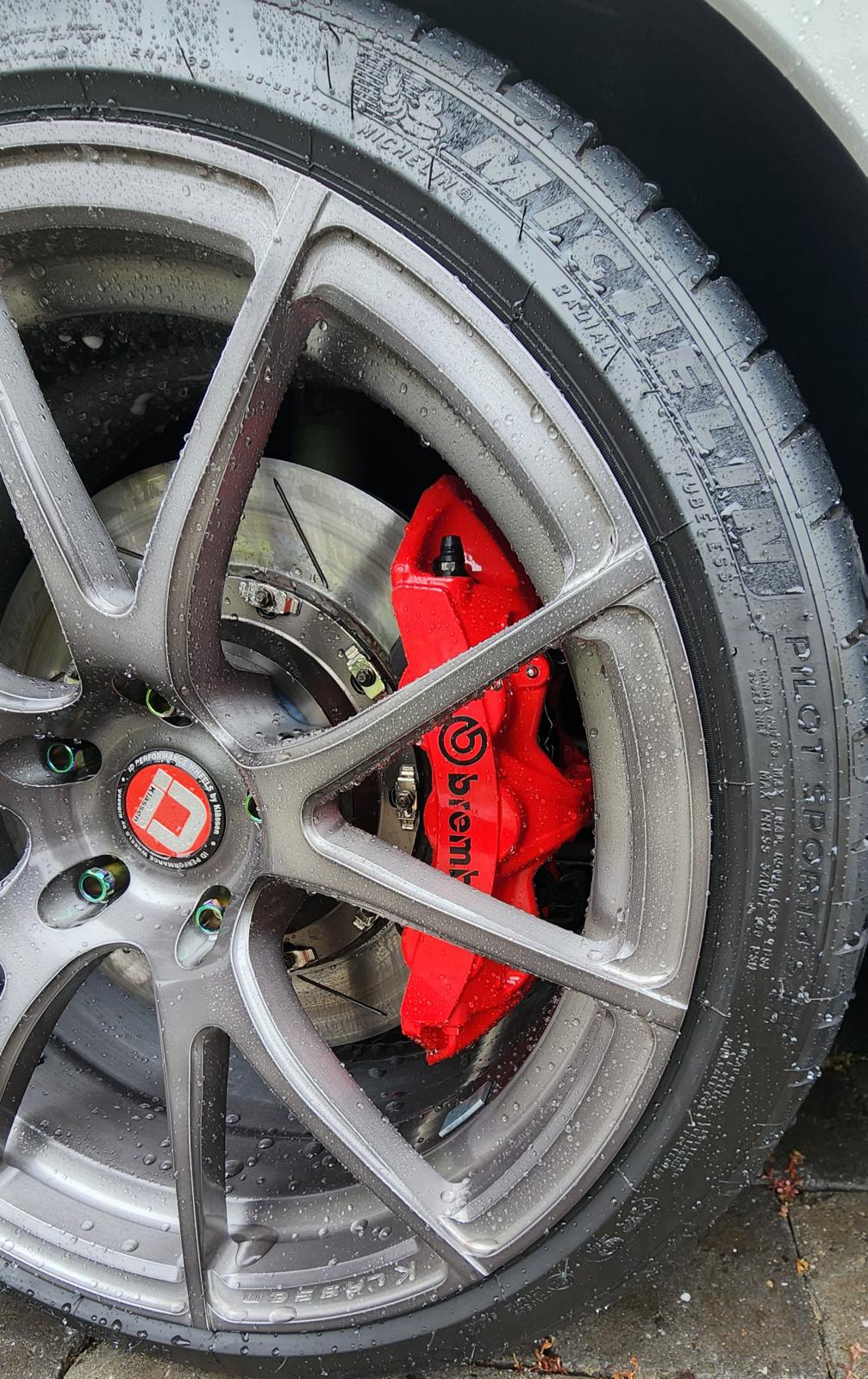

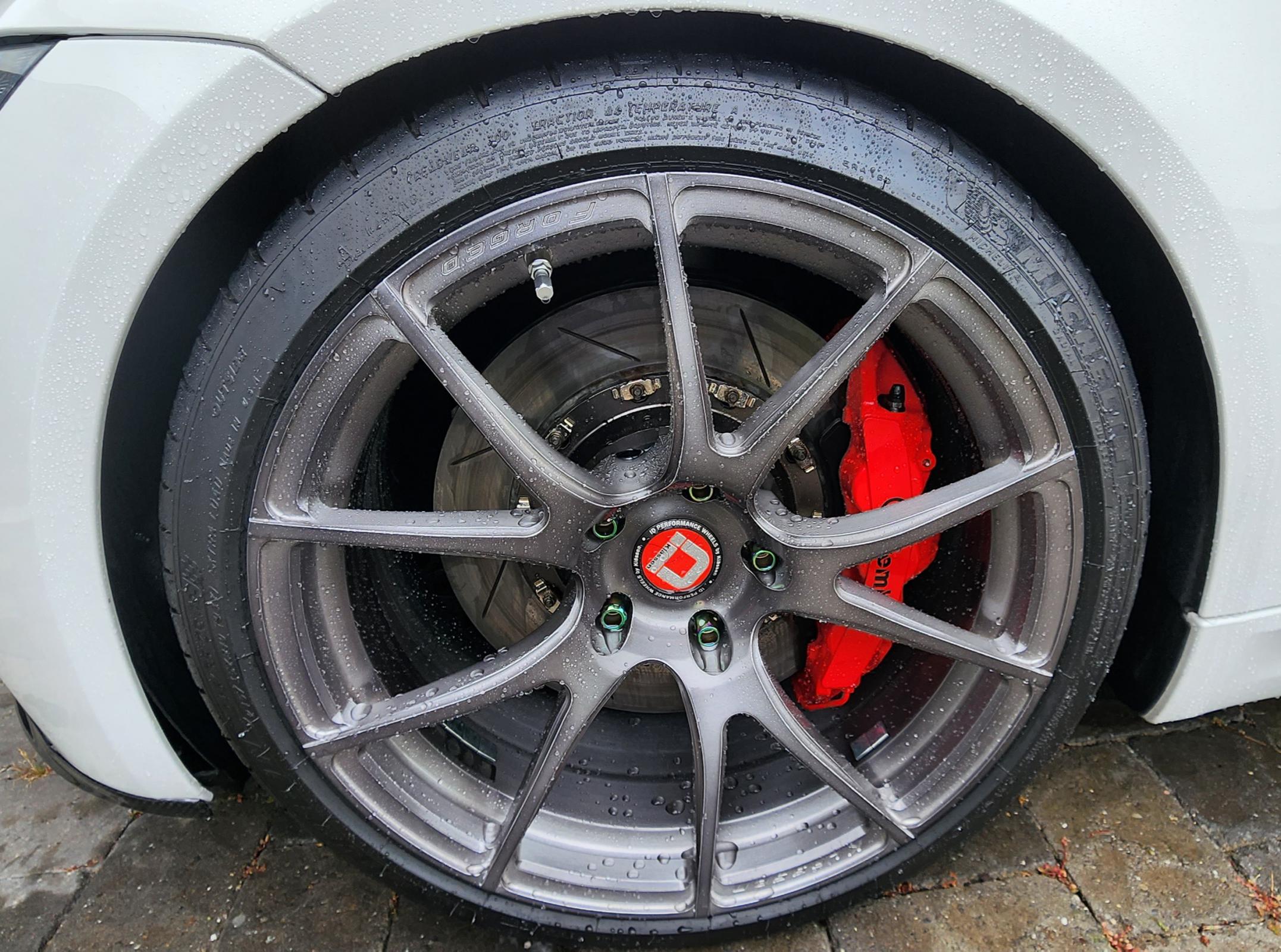

Coated my over 2 years ago with Kamikaze Stance.
You be the judge.

Wow. Two years is very impressive. Just basic washing with a regular soap I assume? Amazing

Yes, I usually just use the same soap (Reset) Iused on the car. However, this was after using Sonax Wheel Cleaner.

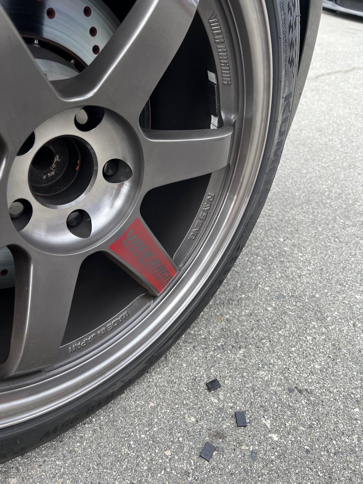

Whatever you do, do not coat the inside of the wheels.
I ceramic coated the inside of the barrels, now wheel weights will not stick to the surface when the brakes heat up the wheels on track. The weights fly off and damage the wheel, brakes and other cars behind me. I have had to use duct tape over the wheel weights to keep them on the wheel.

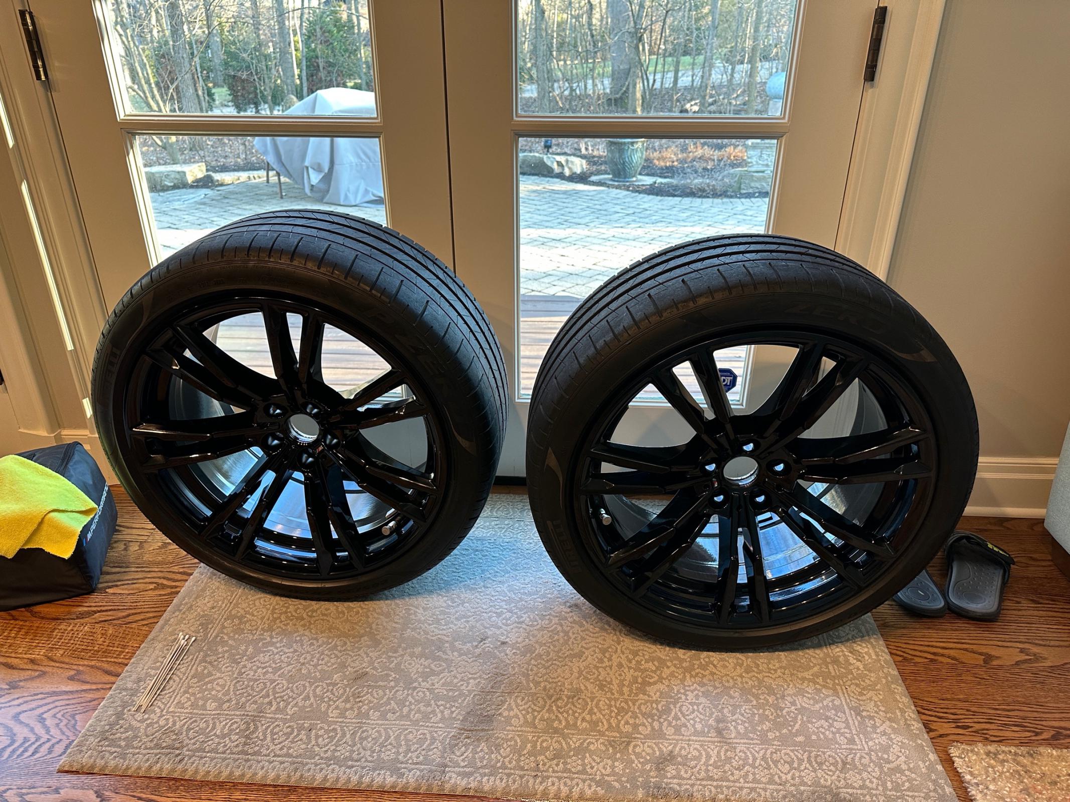

Getting my new car ceramic coated as we speak, and given the small extra charge I am also getting my wheels ceramic coated. Have had that done in the past to 2 sets of my wheels and give how much the M brakes like to dust, it really makes the cleaning/washing much easier.
I have also personally coated a new set of wheels, but mostly because they were brand new and off the car already. So as other have said, definitely a nice to have, and do it yourself if you can.

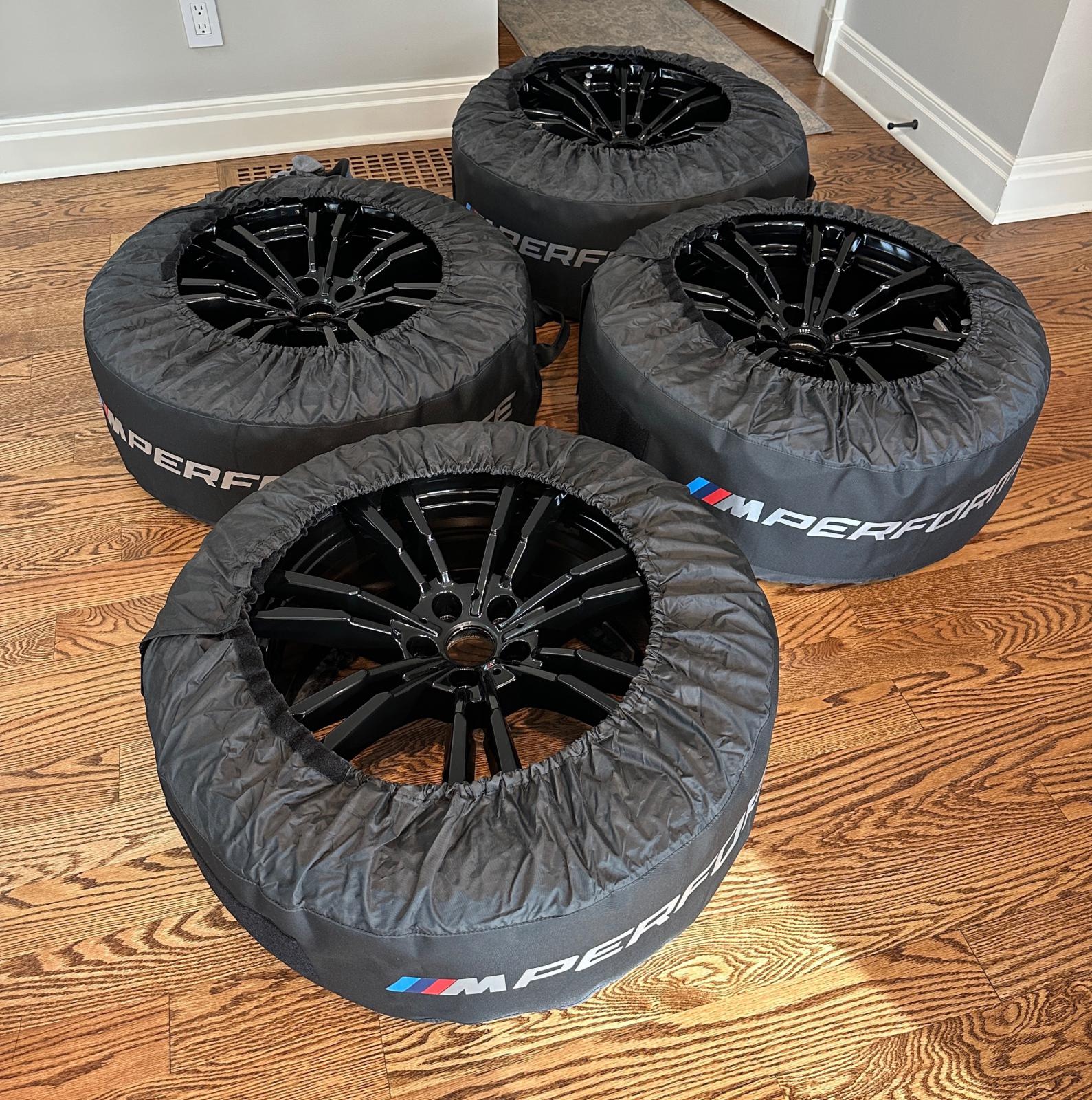

I did it myself with Gyeon Rims when I swapped out my summers for winter set up. Took a long ass time for each wheel but I had it in the living room. The prep as usual takes 3x as long vs the ceramic coating application.
Lol

Ha yeah this is why I'm coating mine after mounting the tires.
A trick though for your situation, try going over the coated area with some polish, that should remove the coating. Don't have to do it for the whole wheel just the areas where you want to stick the weights.

I use my car on track so I go through a set of tires every 6 months or so. It would be pretty impractical to polish certain sections as needed to install wheel weights each time. The tire installers sprayed the whole barrel with solvent/adhesive remover but it has little effect on the ceramic coating.
The solution right now is using aluminum foil tape that they use for heat ducting from the hardware store. It holds the weights in place under high heat. The extra adhesive surface area also helps keep the weights in place. It looks rather ugly but once the barrels are covered in brake dust after a few laps, you can't see it.
This was a non issue in street driving, so for the majority of people, ceramic coating the inside should be ok.
