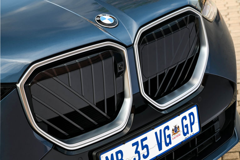

I have heavy water spots on the front grill of my brand new X3 G45. The front grill is made of a satin silver-colored plastic material. It is not metal. It is not paint. I realize there are lots of water spot removers available, but I cannot find any specifically for plastic trim, such as my front grill. I’m hesitant to use the ones for paint, because I’m afraid they’re harsh and may damage my satin plastic finish. I’ve heard some people recommend a mix of vinegar, but again, I’m afraid it will harm my plastic. I’d like to find a tried and true water spot remover for plastic trim. Thoughts? Ideas? Suggestions?

i have been using CarPro Descale with moderate success. for the gloss black trim i dont dilute it, just rub some in, let it dwell then clean off. if your water spots are severe you may need to polish them out.
regarding the common options (CarPro, CG, GTechnic), they aren't too caustic, they are just acidic washes.

Ceramic coatings will make water sports WORSE!
Water spots are mineral deposits left after water evaporates, and ceramic/graphene promote water beading. After water beads, it evaporates and creates concentrated area of mineral deposits left behind by evaporating water.
Please only polish plastic trim pieces after everything else failed!
Plastic is fragile, and you are as likely to polish through the outer trim coating veneer layer as you are to only abrade the water spot deposits!
More in the description of this product:
https://diydetail.com/products/water...s&_ss=e&_v=1.0

Ceramic should sheet not bead. Ceramic will also be an additional barrier. I wasn’t suggesting polishing plastic, just paint.
