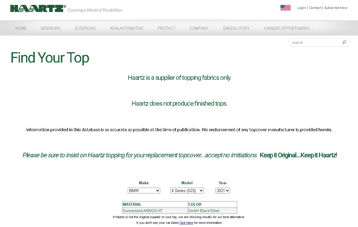

I have a 2022 M8 Vert, the top feels like cloth. 303 is good for leather, plastic and vinyl. What is the BMW vert top cloth material called?

Found this today.....
Looking for best advise to clean the roof on my 420i G23.
Have used Fabsil Gold on previous softops (Saab) but want to make sure I use the correct stuff on my new (to me) car.
