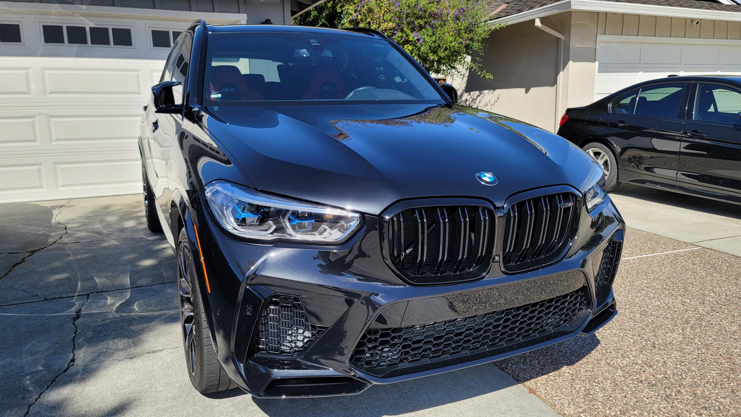

Here is my 3-month update on the Adams Graphene coating.
I applied the coating 3-months ago, and the car sits outside 100% of the time. It has been driven in the rain, and I put about 2,000 miles since the coating was done.
Since then, I have NOT physically touched the paint. Once a week, I spray it off with high-pressure water, and use a leaf blower to dry the car. It literally takes me under 10-minutes to do this. The only towels that touch the car is I use towels to wipe the windows. That's it.
I just hosed off my car today and this is what it looks like everytime.
The color is black sapphire metallic which IMO is the toughest color to take care of.

      05-06-2022, 02:09 PM   #27
schandok
17
23
Drives: 2022 X5 s40i
Join Date: Jan 2022
Location: Texas
looks nice.
Can you share your experience on applying the coating?
Also, which leaf blower are you using?
      05-06-2022, 02:22 PM   #28
skyline408
skyline408's Avatar
1660
1,268
Drives: 2023 G80 M3 2022 F95 X5M
Join Date: May 2013
Location: Silicon Valley, CA
The hardest part is making sure the paint is clean and free of swirls first. My paint was in decent shape, so I just did a detailed hand wash first. I then sprayed the graphene coating on a Suede micro fiber pad and wiped one panel at a time. The paint will have a rainbow effect when dried. I then used new and high quality microfiber clothes to buff off. Its really not much different than waxing a car, but I took my time.
