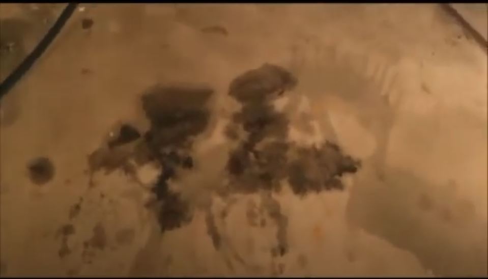

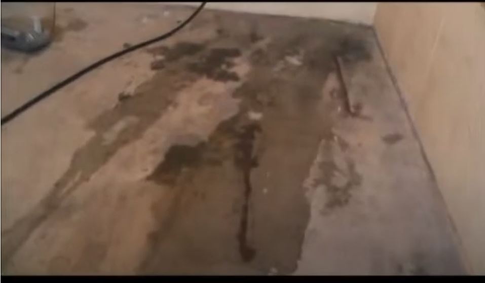

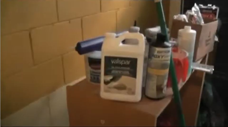

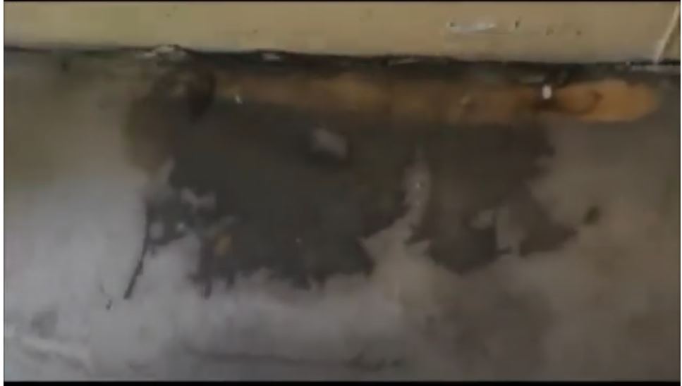

It really does depend....
I was working on my concrete garage floor to epoxy it and I had several oil stains I had to get out before I put the epoxy on
I tried EVERYTHIN, (if I can remember)
Kitty litter did frickkin squat
All manner of degreasers if it had the word De and GREASE I used it
TSP
Detergent
Sawdust
NOTHING, in the end I rented a big ass fllor scrubber cleaner from homedepot, it had a diamond cutting stuff on the bottom and then GROUND the top layer off
Messy as hell, but did the job
CONCRETE IS PORUS and UNLESS you get to it right away and put some sawdust or stuff on it, your done for it will soak in INCHES below, and you can't get it out
125 bucks for 4 hours

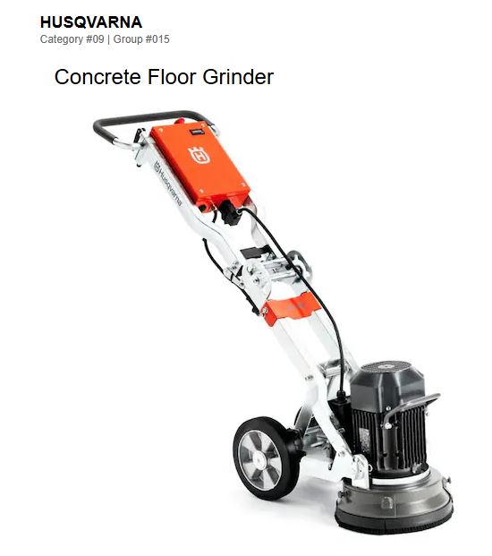

I was also advised to sprinkle cement/concrete powder to remove it, did jack
also tried a point zero tip, on a gas powered pressure washer
see also below
      03-05-2025, 09:30 PM   #15
nazali
nazali's Avatar
1512
1,249
Drives: 230 2020 vert F23
Join Date: Jun 2020
Location: Total Wack Job
as I said only thing that worked was a floor grinder
