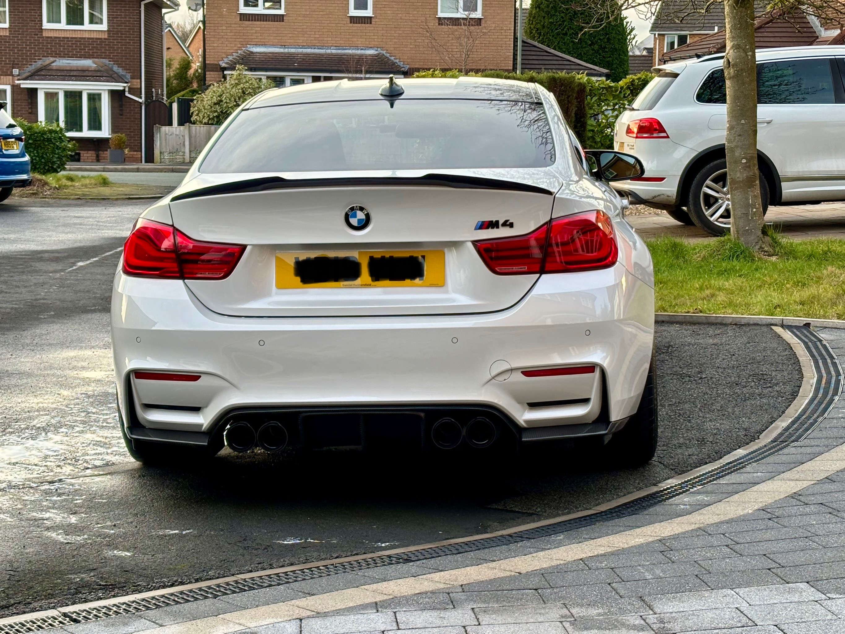

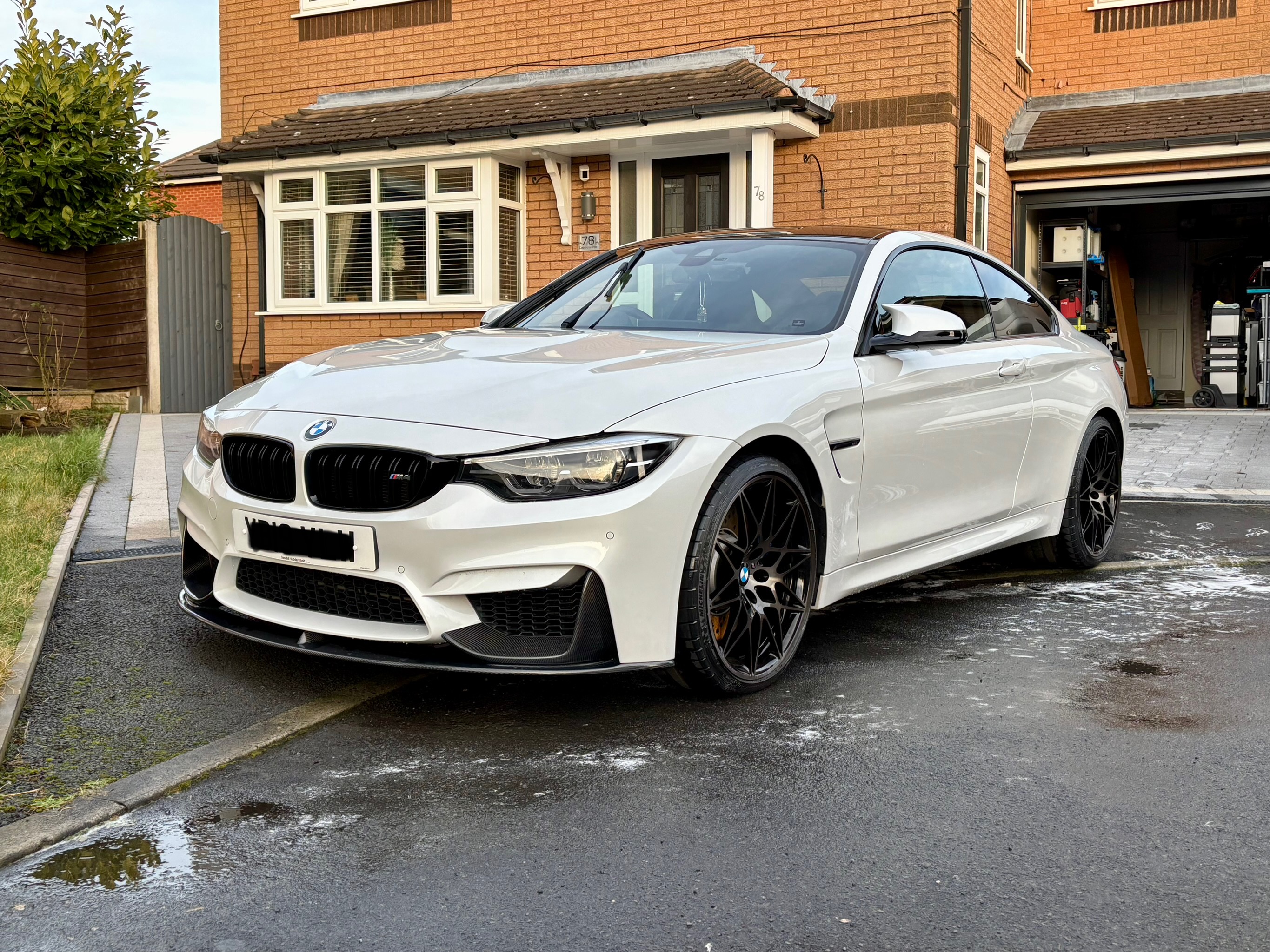

Give the M4 a deep winter clean today.Started with GT Decon diluted 1:20 in a spray bottle used as a pre wash on the lower half then power wash rinsed to remove traffic film.
Wheels sprayed with Labocosmetica Sidero diluted 1:4 in spray bottle to remove iron particles,also foamed with GT wheel shampoo in a IK Foamer them power wash rinsed.
Car foamed all over using GT demineralisation shampoo diluted 1:10 in my foam lance,left to dwell for 5 mins then power rinsed off.
Bucket wash using GT car shampoo then power rinsed off.
Dried using my leaf blower and a couple of towels to mop up the rest.
Glass treated with Gyeon Quick View.This should help keep the windscreen clear through winter.
Tyres treated with Gyeon Tire Express.

beautiful car

Stunning looking car.
I'm a big 'fan' of GT and Gyeon products.
Have you tried Koch Chemie Protector Wax after your final rinse, I really rate it. 15ml in 500ml of water in my foam cannon is more than enough to full cover my X5 M60i, spray on and rinse off. I find it much more economical than Gyeon Wet Coat.

****That looks GREAT! Really nice detailing job. It is snowing in my area, and the roads are covered with salt here so cars are in need of a decent cleaning once everything melts and dries out.

Man that thing looks fantastic.

technically your "winter" doesn't count
Your grass is still green!

Technically it’s not my grass,it’s my neighbours.

Looking out the window at the -16c storm that feels like -23c and looking at this picture with green grass and trees with leaves... then looking at the thread title... Yeah, "winter" is relative.
