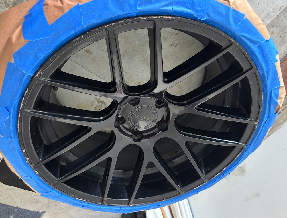

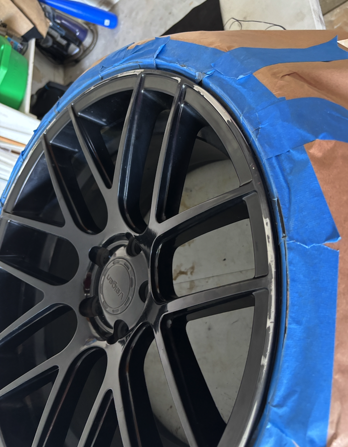

I was going to send my wheel out to my wheel guy, but then decided I'd try and fix it myself. I'm not a paint and body guy but I did have a module on it when I was in tech school. Finished result, damaged wheel, pre-paint version.
The process was basically:
Remove wheel, tape and wrap
Wash
Dry
200 grit paper
2000 grit paper
Clean with isopropyl alcohol
Hit with six coats of gloss black wheel paint.
It turned out surprisingly well but I think it needs a round of polishing to smooth out the finish. The whole process was about three hours.

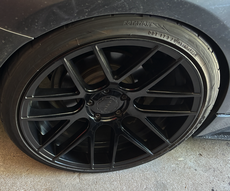

Originally Posted by erickonphoenix View Post
That's nothing compared to what I did backing out of parking space at the airport. I cleared the curb I saw on the passenger side but just grazed the unpainted curb opposite the parking spot. Pretty much rashed half the wheel.
About all you can do in this situation is remember somewhere in the world there's a man trying to fish with a bucket.
love to hear that and sometimes I need to remind myself of this.
In fact 2 weeks ago there was a construction crew who blocked my car into a spot. I attempted to get out and scratched my new beautiful black G80 rim. Right when it happened I was so upset...then my Dad said...woah son. if thats your biggest problem than your not doing too bad.
I went to Auto parts store and picked up sanding blocks 800, 1,500, and 2,000 grit and cleaned the area up. Then I taped off and sprayed gloss black 3-4 coats. Then I hit it with wheel clear coat for 2-3 coats.
It turned out okay..not perfect but not noticeable from a distance.
