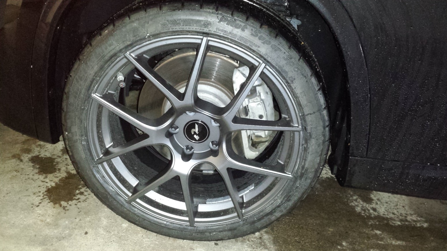

I'm pretty excited...my new wheels arrived today. Renn motorsport RS51 19in wheels. These will be my daily wheels; they are 9.5 square, ET35 and I plan on running 265/35/19 on all four corners.
These wheels are relatively new to the market (purchased from Sonic Tuning) but are JWL and VIA certified (with TUV pending). They are flow-forged, and only weigh 21lbs each for 19x9.5 ET35 which is amazing.
From what I can tell the construction seems pretty good, and finish is uniform and stunning.

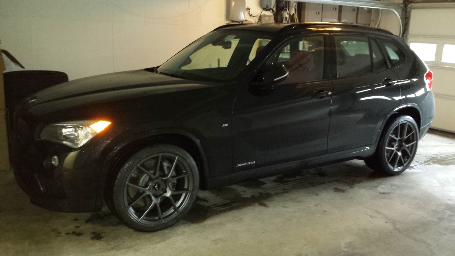

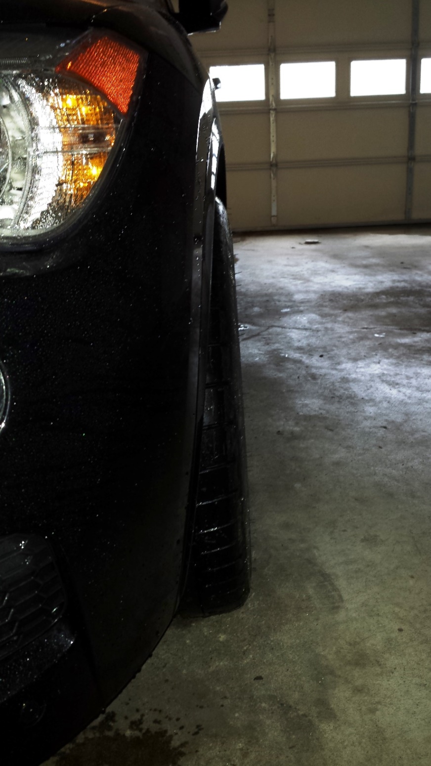

So turns out that the car definitely does not need a fender roll for 265 square! You need a 10mm spacer in the front (5mm is too small) with et35 wheels.
The upshot? Since I don't need a fender roll for 265, I will try a 285 square setup for my track wheels
Here's a crappy cell phone picture of what the wheels look like - the car is not lowered yet, I will probably be ordering a new suspension this week and take proper pictures with my camera once the rain stops and I can detail the car.
