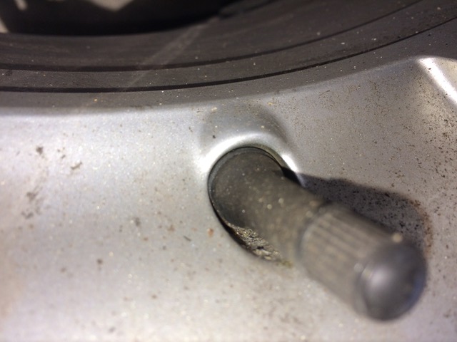

I have looked at several sets of wheels / tyres on auction sites. How do I tell if my wheels have got the TPMS sensors in them please?
      01-13-2017, 09:49 AM   #14
vstolpner
29
673
Drives: 2019 F39 X2 m35i
Join Date: Sep 2015
Location: Vancouver, BC
If you're in the US, they have the sensors. If you're in Canada, they don't.
You can also look at the valve stem - metal stem means you probably have sensors
      01-13-2017, 10:01 AM   #15
Niscars
13
26
Drives: X1 (E84)
Join Date: May 2012
Location: France / UK
Neither - UK. The valve stems are rubber. Looks like no TPMS then.
