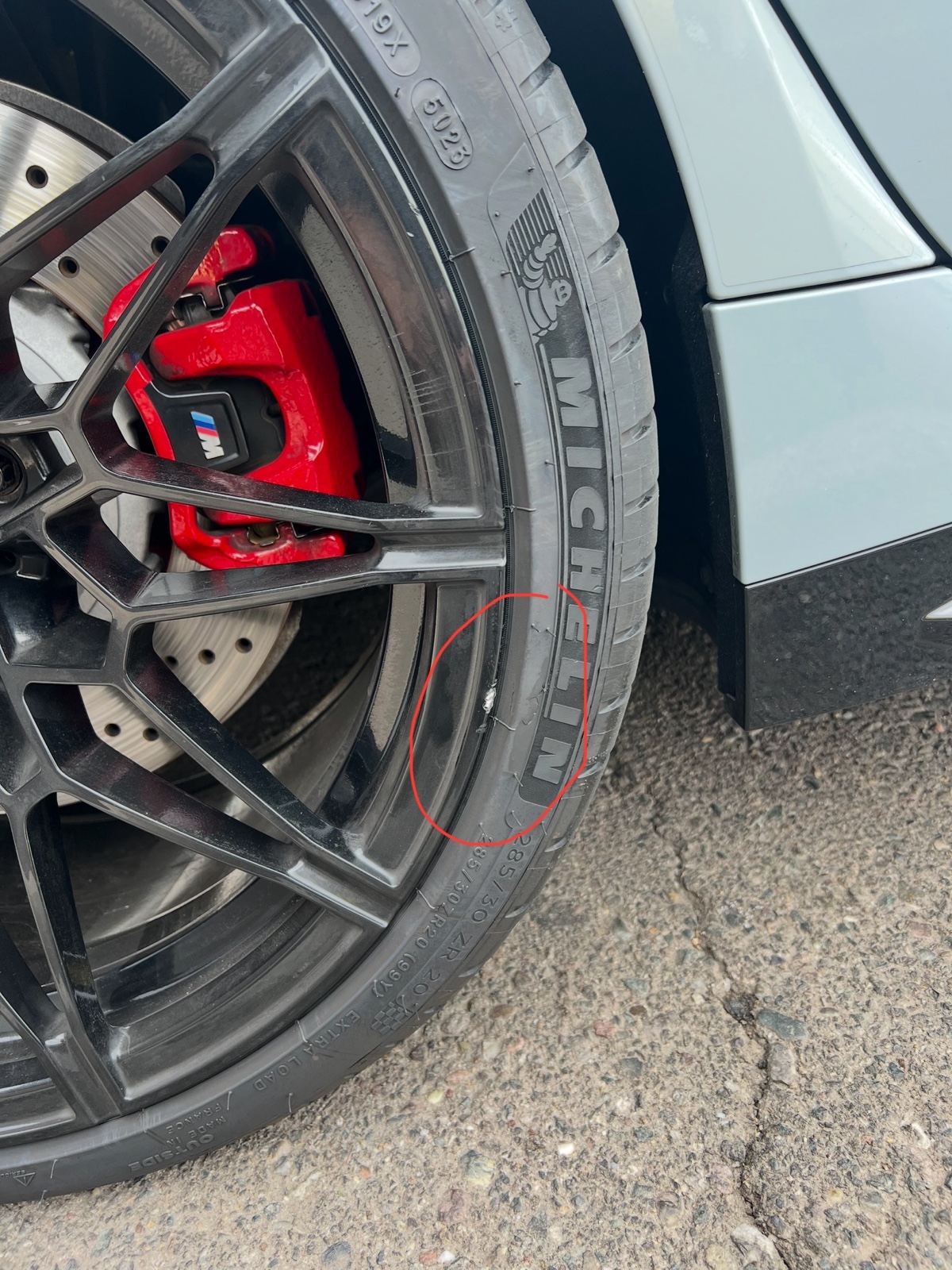

How can i fix this little curb mark?
Hey everyone so the other day, i ended up cutting a turn too close getting out of a parking spot and just noticed it curbed my rim a little. I’m kinda freaking out cause this never happens to me. Any recommendations how to fix or should i just call a rim repair guy? Just trying to see if it’s something i can do myself or if you recommend getting it done.
Thank you!

Rim repair guys will take care of that in no time. Should not be that expensive.

~$200 minimum in northern VA/DC area.

Spot on, I paid $225 a few yrs back to fix one hell of a curb rash I had on a wheel on another SUV I had.

That sucks. How about using a black permanent marker to make it stand out less or some black touch up paint. Once touched up nobody but you will know it's there.

From my understanding if you have 1 wheel repaired you may notice a minor colour difference to your other 3 wheels. Therefore, you may need to repaint all 4 wheels! Just depends on how picky you are!
Have a go at repairing it yourself before calling your local wheel repairer!
1. Start by thoroughly cleaning the rim to remove any dirt and brake dust.
2. Use tape and plastic sheets to cover the tire and the areas of the rim that are not damaged.
3. Use sandpaper to carefully sand down the damaged area. Start with a coarser grit like 200 or 400 to smooth out the rough edges. Gradually move to finer grits like 600+ to smooth the surface further. (Attaching sandpaper to a power drill using an adapter works best and will save you a lot of time sanding. If the damaged area is very close to the tyre, it is best to release air from the tyre to allow you to get right up into the edges).
4. After sanding, clean the rim again to remove any dust or debris from the sanding process. Use a microfiber cloth and a mild solvent if necessary.
5. Apply a thin layer of automotive primer to the sanded area. Follow the manufacturer's instructions regarding drying times between coats.
6. Once the primer is dry, apply the paint in thin, even coats. Allow each coat to dry completely before applying the next. Multiple thin coats are better than one thick coat to prevent runs and achieve a smooth finish.
7. After the paint has dried completely, apply a clear coat to protect the paint. This helps to blend the repair with the rest of the rim’s surface and provides durability. Apply the clear coat to the entire area of the wheel including the undamaged area to achieve a well blended paint job.
8. Carefully remove the masking tape from the tire and rim.
9. Optionally polish the wheels at the end for a mirror-like finish.
If you mess it up after giving it a go or if you are not comfortable in doing the work yourself, then get in contact with your local wheel repairer!

Did you mention where to get the correct paint? I must not have noticed!

I believe the rim style and rim colour name may be embossed on the inside of one of the rim spokes, may be worth taking a look?
As for where to buy the paint - online shopping is a good bet, try searching for oem or genuine bmw paints although may be difficult to come by. I know in Australia one of the major automotive parts retailers offers paint matching and mixing services.
Another option is to take the car into a paint garage and get the wheel colour matched, however, I've got a strong feeling that original posters rim colour is 668 Jet Black - being black it is one of, if not the easiest colour to touch up.
Above colour is just a suggestion though. I would advise confirming your own rim colour before commencing painting!

If its a black wheel...I've used black rattle can BBQ paint to good effect for years.
Sand, clean, mask up the area and paint thin coats.

NFW. Never happened.

To do it professionally you obviously have to add material to fill the crater, sand a larger area around the damage, paint and blend onto the existing paint.
In my opinion this is something you should just touch up yourself, unless you are ok to pay someone to do it.
Dremell type tool to remove raised edges only and smooth out any roughness in the crater.
After that simply touch it up with touch up paint that is as close to the original paint.

No point in repairing that. Come on now. Touch it up with some paint you have lying around and go do something else.

Looks like the tire has a nice slice there as well. Keep an eye on it. The raised edge is designed to help protect the rim but not sure how deep that slice is.
