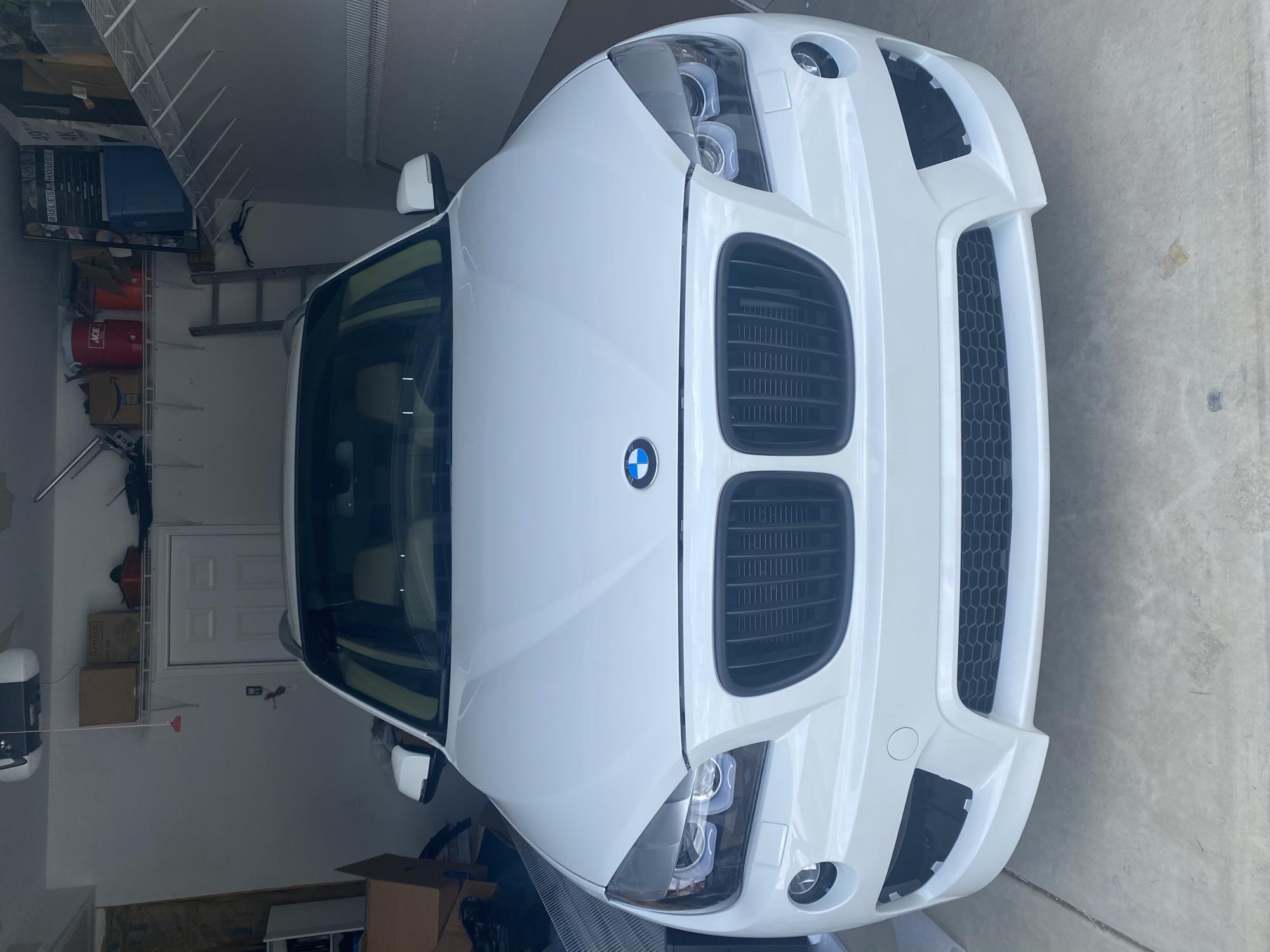

well i just started my M bumper swap, looks like the fog lights are different as well and of course the grills!

Wasn’t bad at all but I do everything on a budget and bought all of my parts off of eBay

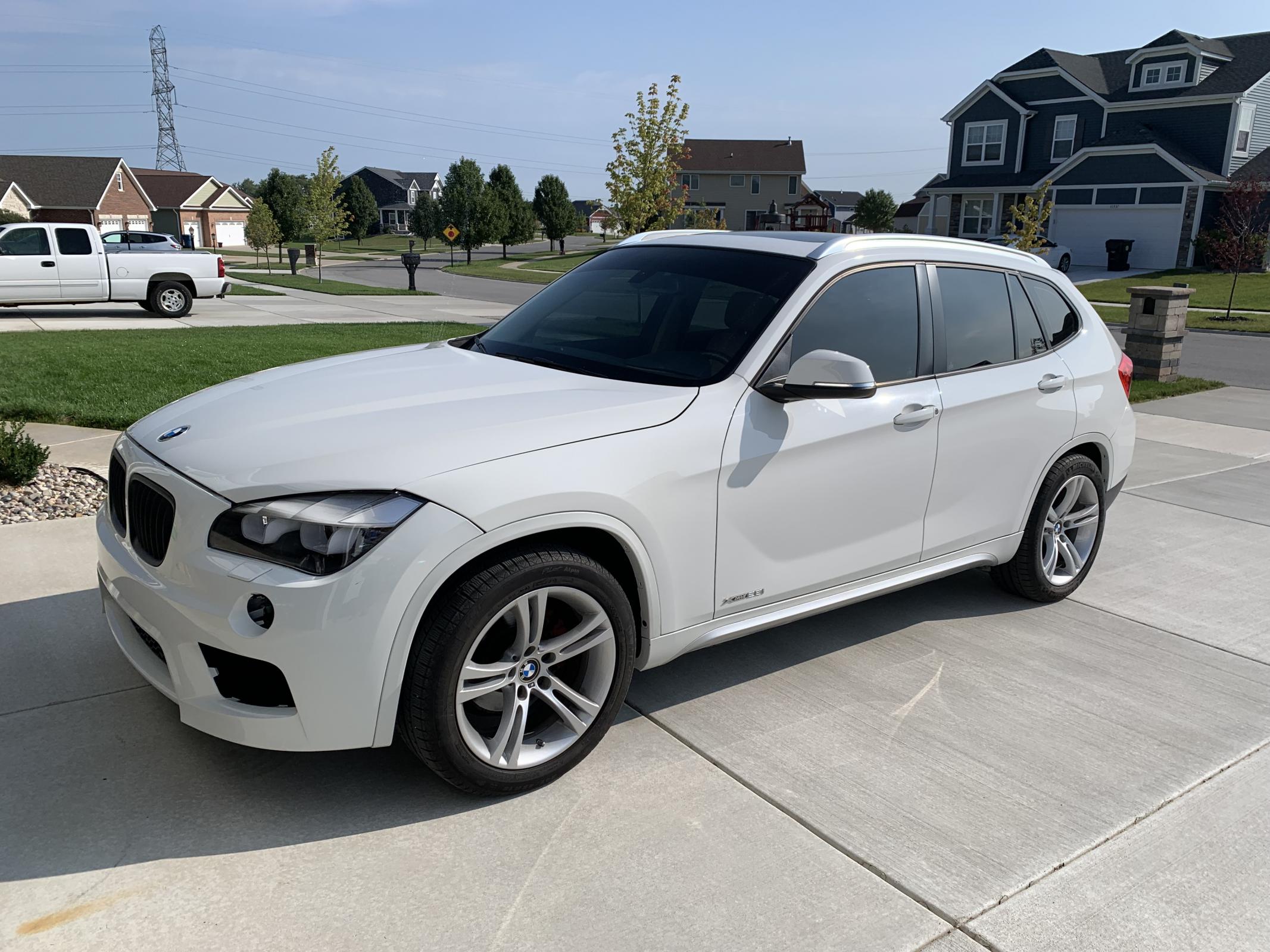

i snagged the bumper off of ebay already painted, picked up the m sport fender flare wheel arches on ebay, painted my rocker panel side skirts:
Need any other parts with that like odds and ends?

the smaller lower front bumper grills weren't that abundant but they are out there, I would start looking for those on ebay if you are looking to do on a budget. I just went with some aftermarket $36 foglights not oem

nope, no brackets or anything additional needed surprisingly...the headlights i just picked up off ebay since i didn't have factory angel eyes xenon style (just blah halogen)

Make sure you get a bumper that has the washer cutouts and you should be good
