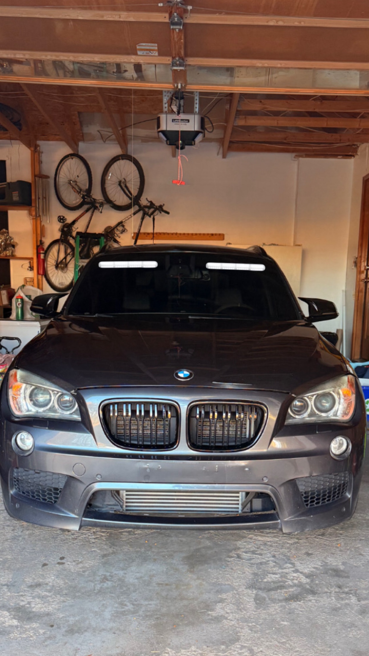

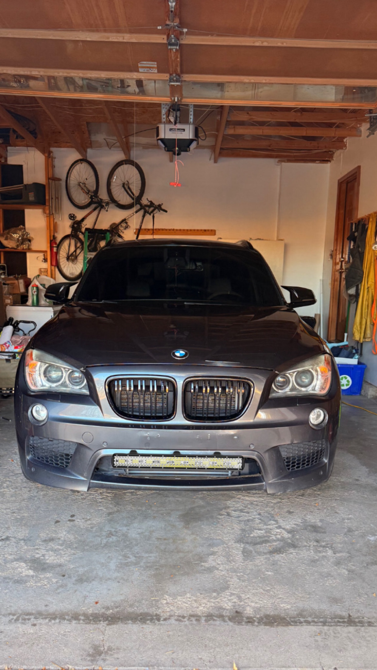

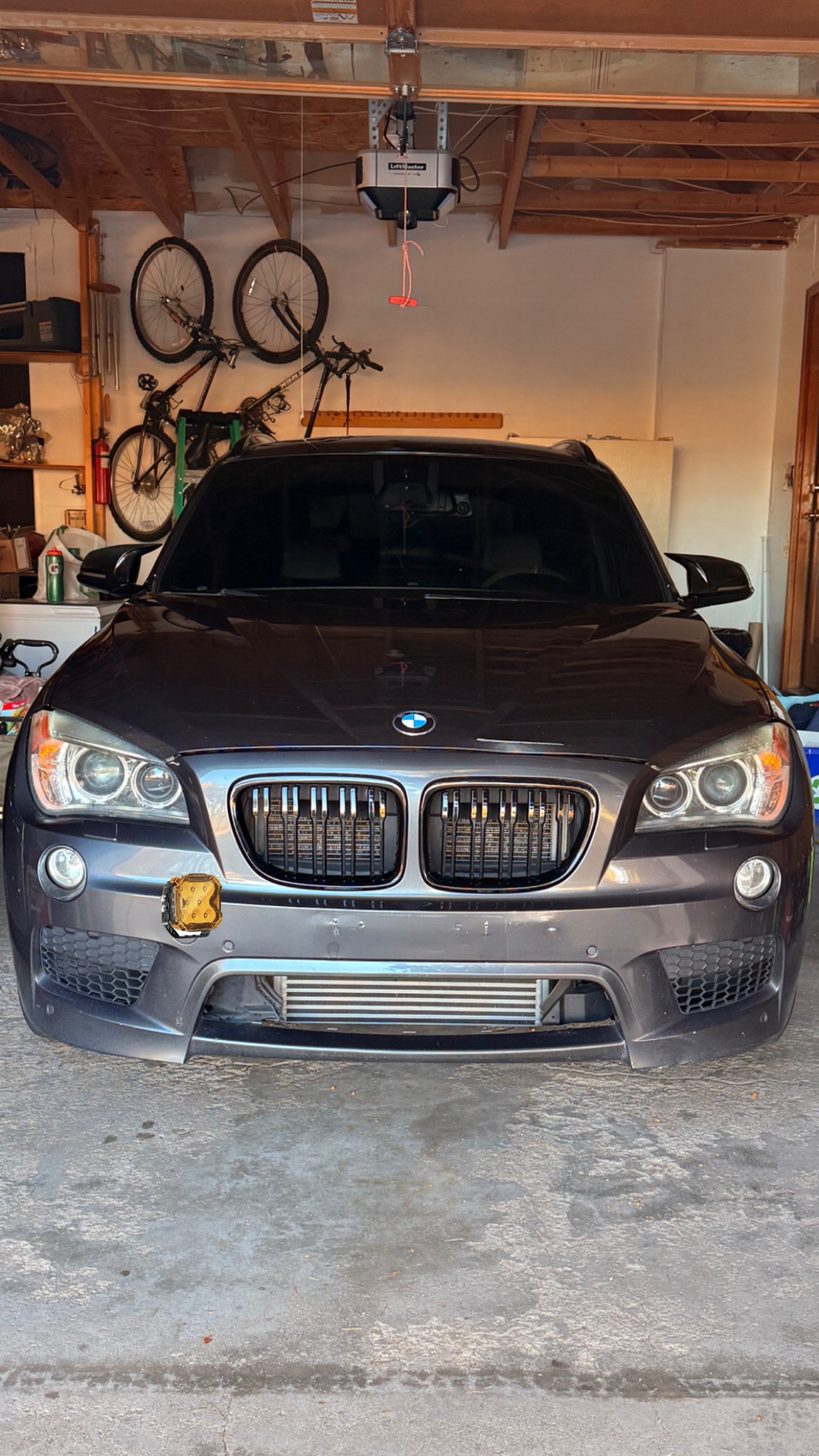

Hello all, id like to start off by saying i know i could get better/bright headlights but i have fairly new ones and they work fine. Im purely looking for great visibility at night, as i have tint on my windshield and live in a wooded area in colorado with too many deer. I thought of this idea that i looked up and only saw replicated once for some porsche suv "mono tow light" on the euroweise website for $165 😂. Firstly, Im thinking of buying this bmw towhook, taking out the end piece and adding a spacer so the hole sits vertically and i mount a pod light on it and run the wiring. This pod light is insanely bright and has an amber cover for snow and for protection. Secondly im thinking of doing these "police/emergency" visor lights that are all white. Ive tried to find one that switches from either white OR amber, but they are for emergency so they rapidly switch from one another. Some do have the takedown but this is not what i am in search of so the all white ones it would be which is fine. Ive driven in blizzards and made it so no biggie on the amber. Lastly i would get this 25 inch "50000 lumen" light bar and mount it in front of the intercooler. I have mockups and the product images and im unsure of whats gonna be the best route both long term and ease of installation.

also you don't want to install lights above the hood. you will get glare

If you're going to go with low-mounted lights, look into using the wires for the fog lights or replacing them outright. That's probably the easiest electric solution instead of running and mounting a whole new setup.
Wouldn't recommend top lights unless you're willing to drill. Also just my opinion but I think it looks goofy, even on trucks and vehicles that have dedicated mounting points.
